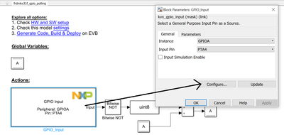

If you did the above steps and still see the problem, then can you please try the next: open the GPIO block and press the Configure button. That action will open another tool - MCUX Configuration Tool (it might take a little longer when opening this tool for the first time), and will open that .mex file I mentioned above with the peripherals configuration parameters. I want to know if it opens this configuration on your side and if you noticed any errors reported.

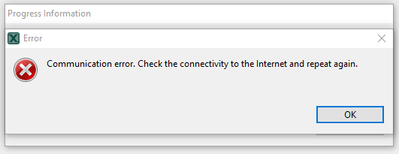

However, when I open the Configuration Tool, I am presented with the following:
I am connected to the Internet. All the settings did not make the tool budge. I also tried importing the SDKs that are shipped with the MBDT, but to no avail. One interesting thing I noticed, though: when trying to create a new configuration in the Config Tools v9, I got this:
Any ideas?

What do you know? I got it to work!
I had to go to the MCUXpresso SDK Dashboard, go to the SDK 2.8.0 that I had created in the past for MCUxpresso IDE, download just the config data archive, "SDK_2.8.0_FRDM-KV31F_ConfigTools_data.zip", go to the Config Tool at File -> Data Manager, Import the file, and then from there on all built. Of course, the app also works on the target, so all is honky-dory!
