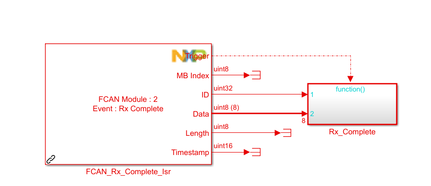

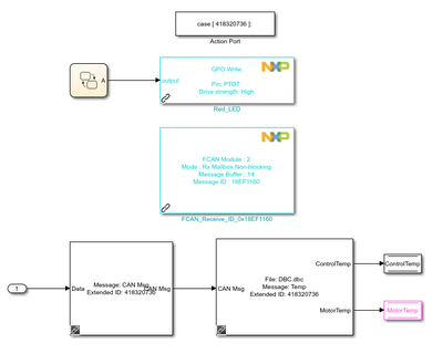

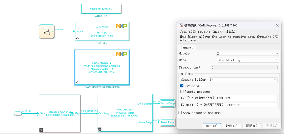

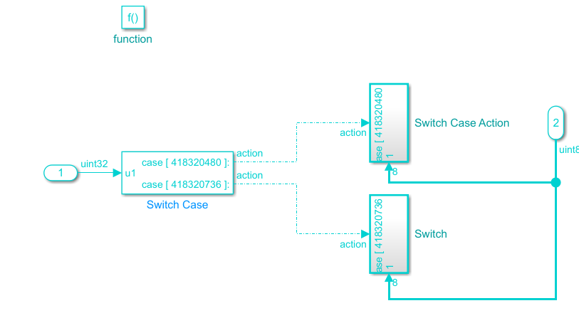

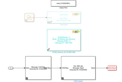

     I want to accept data with different id,but I can only accept data of 0x18EF1060 in this setting,  and cannot accept data of 0x18EF1160. Can you help me to see what the problem is?
Thank you

  Changing the Message Buffer can solve the problem. Hope you can help you.
