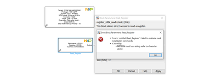

rathi_tg
Hi @mariuslucianand
 I am using read write register in order to get the data from i2c block as I have observed that the data is not cleared in i2c register when the salve is removed after a period of time. So, i am planning to clear the buffer initially before every read operation.
But, when I select the i2c registers from read write Register i get the an error whose snapshot is been added. MATLAB Version 2020a.
Gopal
