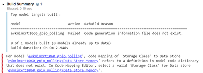

I have installed MBDT successfully, I can generated code use the default folder path.
But if I move the gpio_polling example to a new folder, I cant build it ok.
The message as below:
Build Summary
1
Elapsed: 0.4 sec
Top model targets built: Model Action Rebuild Reason ====================================================================================== evkmimxrt1060_gpio_polling Failed Code generation information file does not exist. 0 of 1 models built (0 models already up to date) Build duration: 0h 0m 3.639s
文件标识符无效。使用 fopen 生成有效的文件标识符。
Matlab version is 2021a.
MBDT version is 1.2.0

nxa11767
Hi @Leon_Li1 ,
Did you extended error look like below?
This is caused by the initial model being created with an older version of matlab, and some things changed in the data storage options.

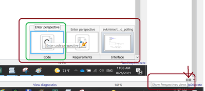

To fix the issue click on a small icon in the left lower corner, to open the model perspectives:

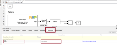

Enter the Code perspective, and in Data storage type, fix the error for the 'A' storage variable:
Hope this helps,
