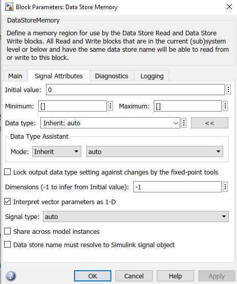

I am using Data Store Memory block to store and view the data in FreeMaster.
Code Generation parameter is not visible in the block to change the the storage class to volatile.
The code is not generated for the block.
The system target file is: mbd_s32k.tlc
Do I have to make any changes in simulink block.
Please guide me.
Thank you

Hello @srikar_26
For a variable to be seen in the FreeMaster directly with his name, it has to be declared  a Signal Object Class as "Exported Global" or "Volatile" if you use it in an interrupt as well. Otherwise, Simulink will declare the variable inside a structure starting with the model's name.
For that, depending on the Simulink version, you have to the to the Model Data Editor and select the Storage Class.
Hope this helps,
Marius
