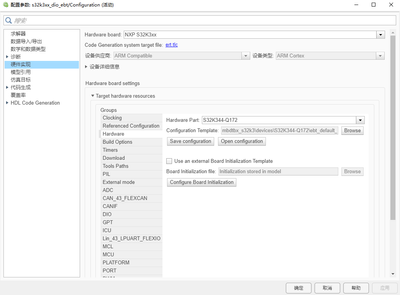

I am using S32K3X4EVB-Q172 board with Simulink in Matlab 2021b.
MBDT Version 1.4.0
I try to use the Dio Example, in whitch the Red LED will flah and the Bule LED will open when push user buttom.
I have successfully download the program. however, I found that the RGBLED never shine, instead, the Reset LED behaves as what RGBLED should behave: it flashed and keep open when I push user buttom.
I have change the hardware to S32K344-Q172 in Model Configuration.
Please help me if you have suggestion.

Hi, @RegulusCheng,
Thank you for using MBDT on your projects.
It looks like your evaluation board enters into a sequential reset state. Please review the following thread  S32K3X4EVB-T172 with MBD which addresses the same issue.
Victor

RegulusCheng
Thank you, Victor
I change the Jumper31 as you said in that thread, and the board runs as wish.
