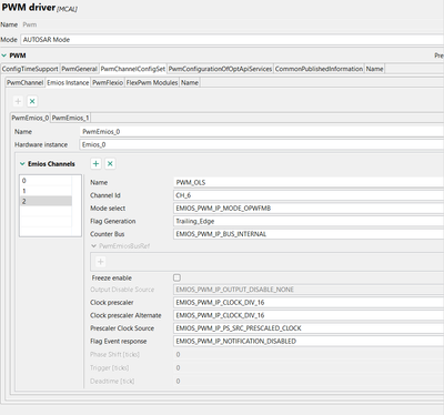

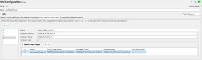

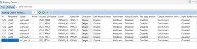

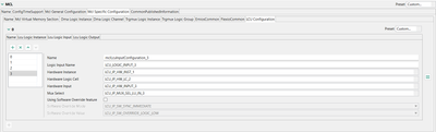

Hello Nxp team,
We are also working in Pwm_trigmux_lcu to generate the pwm pulse in Lcu pins.
And we have checked the model given by nxp team in this post - Re: Pwm_delay_in_trigger_pulse - NXP Community ; "s32k312_pwm_lcu_mod_carrier_s32ct.zip" and we have also used 'PTA0' as the High side pin
but we need to configure the 'PTC10' pin as the Low side pin, but we can't be able to see the waveform in Ptc 10 pin.
we have attached the photos by steps of which we configured.
Step-1: Pin configuration
Step-2: Pin config in port driver
Step-3: Pwm driver configuration
Step-4: Trigmux configuration for Ptc10 (Lcu1_out11)
Step-5: Lcu_instance configuration
Step-6: Lcu logic input config
Step-7: Lcu logic output configuration
Kindly check this configuration, we think that we have made some small mistake in this.
We want to generate High side pwm pulse in "PTA0" - this is ok
and Low side PWM pulse in "PTC10" - this we tried but the waveform is not able to view.
Kindly help us to resolve this issue.
