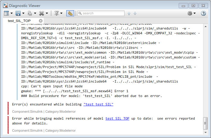

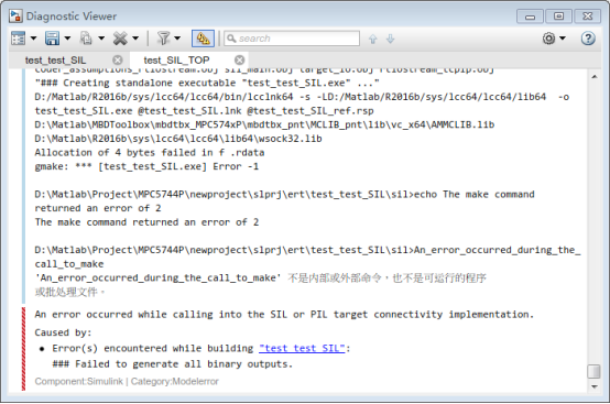

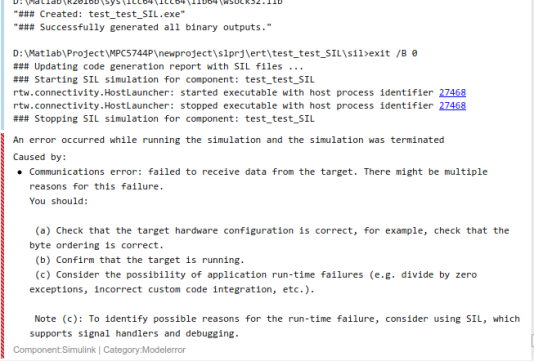

yangyanhui
Hi Daniel,
I'm sorry that it didn't solve my problem.
Errors occur only when I use partial motor control functions.
Detailed information is described in the attachment.
Thank you very much!

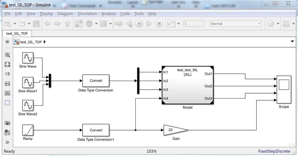

Daniel_Popa
Hi yangyanhui‌,
I played a bit with your model. First thing i noticed is you have different setting for solver between test_SIL_TOP and test_test_SIL models.
Unfortunately, i can't run your original model on my side since i do not have license for the Simscape Power System to use the 3 phase side generator - but i changed a bit the harness model to use standard Simulink blocks and it works fine.
Please find attached the models. Can you please try it on your side and confirm these ones works?

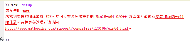

Daniel_Popa
Before going to other computer can you please run this command into your Matlab console and tell us what returns ?
mex -setup
I have a feeling that your Matlab is not configured to support the Microsoft Windows SDK 7.1 compiler.
6,853 Views
yangyanhui
Hi Daniel,
Yes,you are right!
When solve it ,I will let you know!
