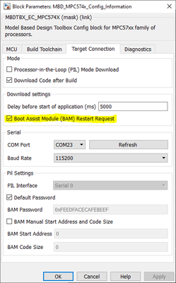

The mention I have is that you can flash the bootloader only once. In order to force the board to enter the bootloader for the newly generated code, you have to check the BAM Restart Request. This will show a popup asking you to manually reset the MPC board and then, within 5 seconds you have to press the ok button in the popup.

I activated the BAM restart request.
The some thing. Nothing happens.

The BAM selection that I was mentioned in my previous response is used only to let you know when to restart the board. So I was not expecting this to make the code work.
