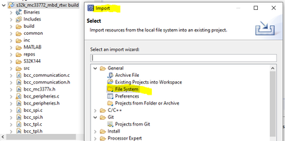

I have Successfully built the code which you have mentioned above and Establish communication using C Code rather than using the Tool box. But, if I import the xml file of the Project to design Studio I encounter various Errors which are unable to include the Files present in bcc.

You have to import the files from the bcc folder as well in the S32DS project.
Right click on the project name, select Import. Look after General -> File System and select the bcc folder that contains the bcc_*.h/.c files

Thank you for your help!! The import was successful.

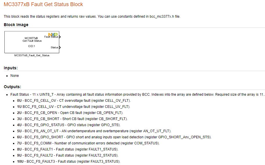

To read the fault registers, you can use the "Fault Get Status Block" directly from our toolbox. This will return the 11 registers described below. This block uses the "BCC_Fault_GetStatus" function.
If you are interested in a register value that is not returned by this block, then you can read directly that register by using the "Reg Read Block", feeding it with the address mentioned by the Reference Manual. This block uses the "BCC_Reg_Read" C function to do the job.

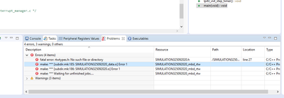

I have Followed the above Steps I get build option but it generates few errors.
What are these specific to and how i could solve them.
