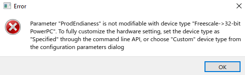

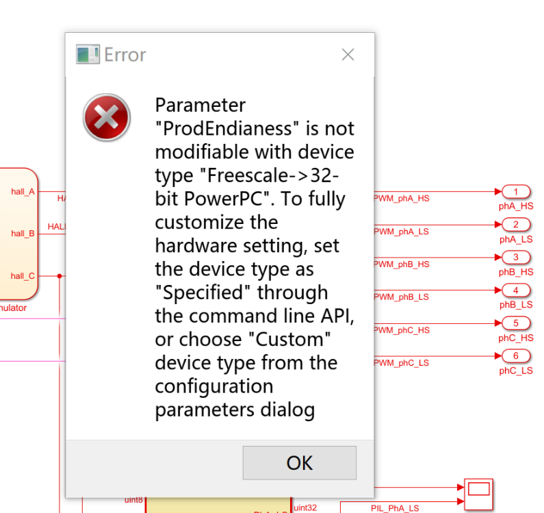

Parameter "ProdEndianess" is not modifiable with device type "Freescale->32bit->Power PC"

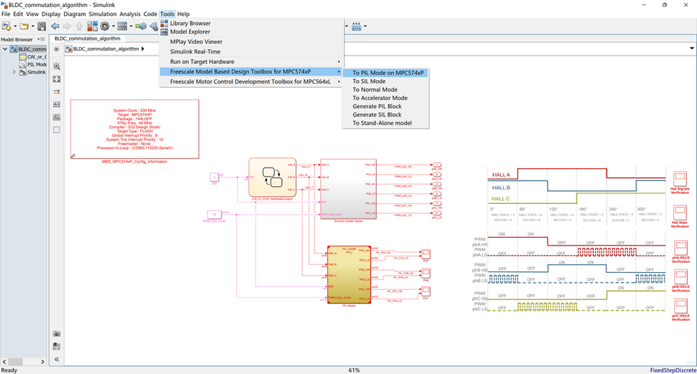

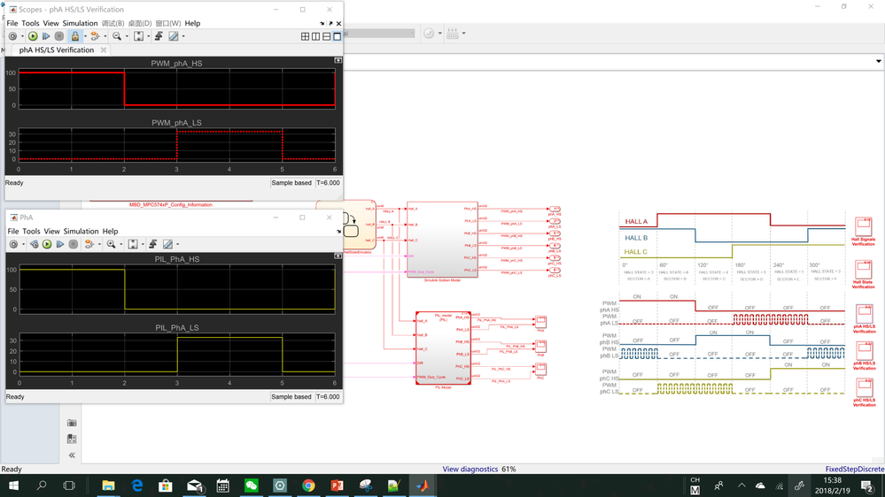

Thanks for the very excellent tutorial on the MBD again, I am currently in PIL lecture of BLDC motor control.
Unfortunately, I encountered the issue shown in the figure below.
I made the following change in the configuration.
And it is still showing the same error. I am just checking if you know a quick fix to this issue. I attached my model as well.  Thank you for the help!

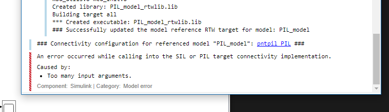

Accroding to Mr. Popa's instructions, I got the same error in Matlab ver. r2018a.
Whether I use your work-around (created an .m file with the given scripts) or not, by hitting the simulate button in normal mode, I got the following error:

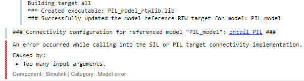

"An error occurred while calling into the sil or pil target connectivity implementation. Caused by: Too many input arguments"

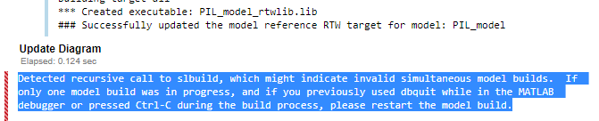

By using the .m file with your script; if I change the mode to PIL-simulation then I got another error saying that:
"Detected recursive call to slbuild, which might indicate invalid simultaneous model builds. If only one model build was in progress, and if you previously used dbquit while in the MATLAB debugger or pressed Ctrl-C during the build process, please restart the model build."

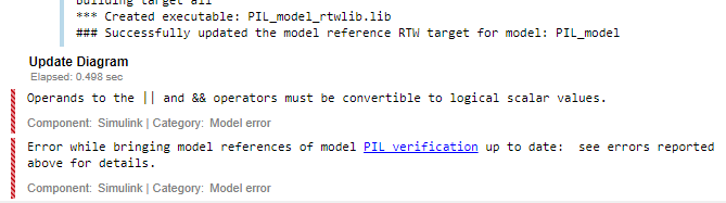

Without your script; if I did the simulation again in PIL-simulation mode then I got a different error as shown below:
Consequently, I would like to know if you or Mr. Popa have an answer to this problem.

paulvlase
Hi aunsal89@gmail.com‌, yujiangwu
You see that error because starting with R2017a the parameter "ProdEndianess" and a few others are read-only and we are trying to update them in our mbd_pnt_set_pilsil_mode function.
Could you try the attached zip file, which should fix the PIL converter and build?
You have to unzip it over the folder where the toolbox is installed. On my machine it is C:\MBDToolbox\mbdtbx_MPC574xP.
Paul

Thanks for the attached folder yet it did not work with r2018a, here is the error I am getting:

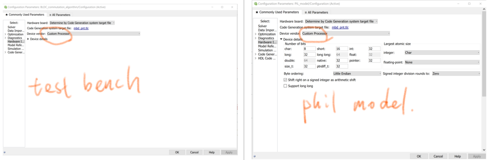

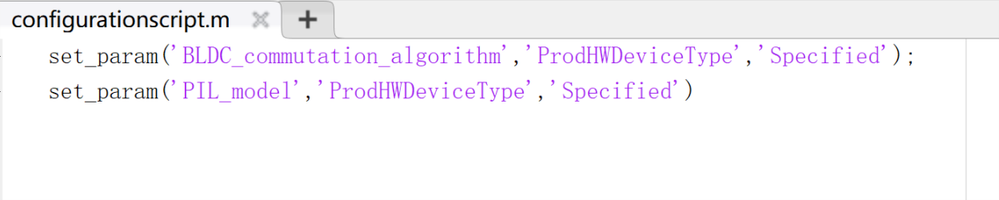

yujiangwu
Hi Dear Daniel,
dumitru-daniel.popa
I found a workaround. I wrote a script to first configure the ProdHWDeviceType as Customed. Then unify the configuration setting between Parent model and Child model. At the end, I explicitly set the ProdHWDeviceType back as Freescale->32-bit PowerPC. Then if you run PIL directly, it works.
The script is as follows:
open('BLDC_com.slx');
open('PIL_model.slx');
set_param('BLDC_com','ProdHWDeviceType','Specified');
set_param('PIL_model','ProdHWDeviceType','Specified');
set_param('BLDC_com','TargetLangStandard','C99 (ISO)');
set_param('PIL_model','TargetLangStandard','C99 (ISO)');%C89/C90 (ANSI)
set_param('BLDC_com','ProdLargestAtomicInteger','Long');
set_param('PIL_model','ProdLargestAtomicInteger','Long');
set_param('BLDC_com','ProdLargestAtomicFloat','Double');
set_param('PIL_model','ProdLargestAtomicFloat','Double');
set_param('BLDC_com','ProdEndianess','BigEndian');
set_param('PIL_model','ProdEndianess','BigEndian');
set_param('BLDC_com','SuppressErrorStatus','on');
set_param('PIL_model','SuppressErrorStatus','on');
set_param('BLDC_com','ProdHWDeviceType','Freescale->32-bit PowerPC');
set_param('PIL_model','ProdHWDeviceType','Freescale->32-bit PowerPC');

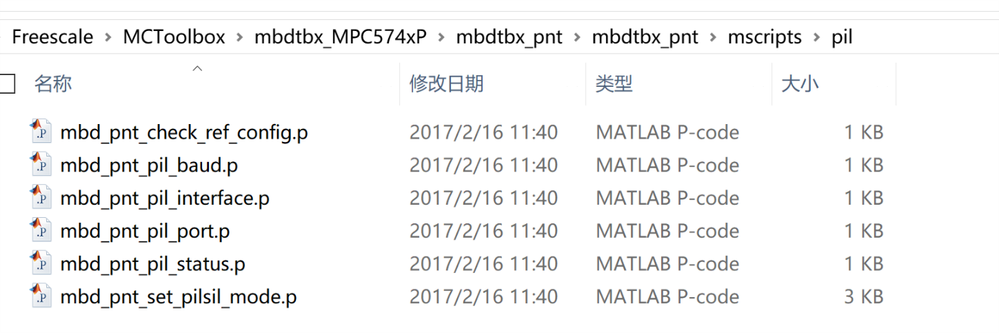

However, I still suspect that there are some bugs within the "mbdtbx_MPC574xP",especially the following protected code.
Please check and make the update if necessary.
Thank you!
Sincerely,
Yujiang Wu
