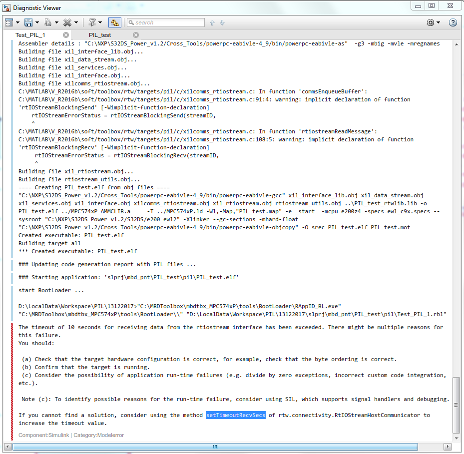

sundarnatarajan
Hi Paul,
 As i am facing similar issue in Matlab2016b i am adding my question in this chain. I have created a sample model myself, when i do  run Tools > Freescale Model Based Design Toolbox for MPC574xP > To PIL Mode on MPC574xP it get an error which similar to above posted by ali. Will this patch solve this issue in Matlab2016b also. Your support is appreciated .

paulvlase
Hi sundarnatarajan‌
Yes, it should fix that error in R2016b too.

sundarnatarajan
Hi Paul,
As per your suggestion, mbdtbx_MPC574xP, MakefileBuilder.p hot fixes are applied and now the above issue is resolved. But when we run a model in PIL mode, below issue encountered.
 Tools version used by me given below.
Matlab – 2016b
MBDToolBox – V2.0.0
S32 Design Studio – V1.2
We have also applied HotFix_1 to HotFix_6 as per below link, after that I have applied your hot fix.
https://community.nxp.com/thread/451804
I have attached my simple test model I have created to test PIL environment, but still face issue could please tell me what is the issue or am I missing some settings still.

Daniel_Popa
Hi sundarnatarajan‌,
Have you configured the serial communication correctly ? BTW, have you flashed the RBF file into the MCP5744P MCU ?
FYI, we have a video showing how to do PIL simulation on MPC5744P:  Video Link : 7845  This video is using the PIL example file shown here: https://community.nxp.com/thread/453726
Please try to run the PIL_verification.slx to validate if your hardware setup is correct.
Hope this helps!

sundarnatarajan
Hi Daniel,
Thank you very much.. I am able to simulate. The problem is in serial communication.
Sundar

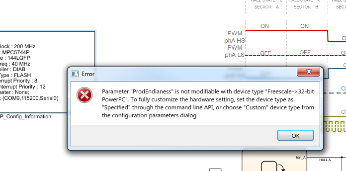

alimeraj
Hi Paul,
I have 2017a as well, which gives me a following error when i try to configure model for PIL.
I am able to use the Toolbox for normal peripherial and direclty download to processor from simulink with both matlab versions (2014b and 2017a) its only the PIL which is not working.
Ali

paulvlase
Hi alimeraj‌,
It works as expected on R2017a.
I think you opened the PIL_model and PIL_verificaiton models in R2014b, and after that in R2017a.
Try this:
1) Run in PIL_verification.mdl from menu Tools > Freescale Model Based Design Toolbox for MPC574xP > To PIL Mode on MPC574xP.
2) Use in R2017a the clean models from the Lecture7.zip archive.
12,176 Views
paulvlase
Hi @ali_meraj,
I can reproduce your problem in R2017a when I run in PIL_verification.mdl Tools > Freescale Model Based Design Toolbox for MPC574xP > To PIL Mode on MPC574xP.
Thank you for reporting this error. I will post a hotfix for this.

paulvlase
Hi alimeraj‌,
This is a hostfix to make the MBD Toolbox for MPC574xP run on R2017a.
Unzip it over theTOOLBOX_INSTALL_DIR. The default folder is C:\MBDToolbox\mbdtbx_MPC574xP .
Please try it and tell us if you have any problems.
