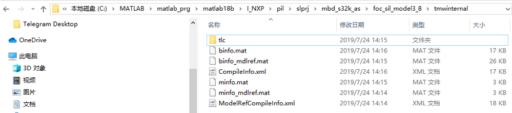

Hello:
  There is a PIL model, which runs after successfully generating mex-file, and the following error occurs, is it necessary to configure some parameters?
The environment is:
win10 1903
matlab2018b
Best Regards!
Liu qimin

Hello liuqimin‌,
Please consider attaching your model here to have a look on it.
You can also try using our latest version for S32K from here https://community.nxp.com/docs/DOC-343949
Hope this helps,
Marius

liuqimin
Hi,Marius,
   Thank you for your reply.
   I'm now using mbdtoolbox_s32k1xx_4.1.0, but when generating PIL or SIL blocks, it prompts that the file binfo_mdlref.mat cannot be found.File, path is C:\MATLAB\matlab_prg\matlab18b\I_NXP\pil\slprj\mbd_s32k\foc_sil_model3_8\tmwinternal\, ,But in path C:\MATLAB\matlab_prg\matlab18b\I_NXP\pil\ pil\slprj\mbd_s32k_as\foc_sil_model3_8\tmwinternal has this file。May I ask whether the wrong path is caused by my mistake?
  The binfo.mat file is also not found when the entire model is running PIL or SIL. As shown in the figure below.
Best regards!
Liu qimin

Hi liuqimin‌,
Can you check that 'Model Referencing' parameter and change it as the model suggest in that error?
Marius

liuqimin
Hi,Marius,
    I modified the Settings according to the error prompt, which caused other error prompts.Finally, the C++ compiler changed to VS2017, the error disappeared. but ran to the RappId Bootloader, has not been able to connect to the MCU board.The same error occurs as running the instance model.
  Best Regards!
