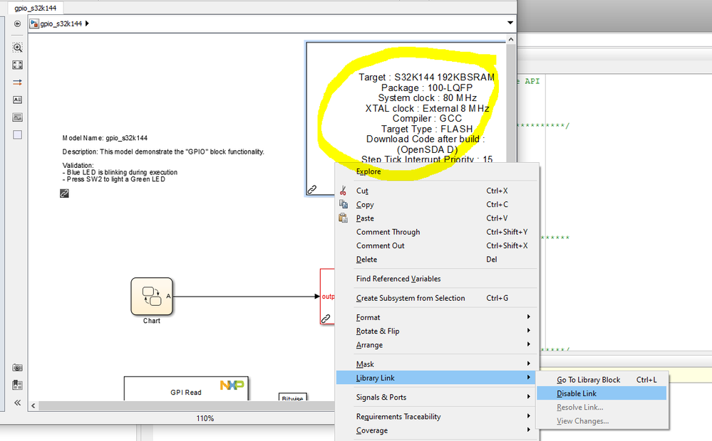

mariuslucianand
Hello @neffnan ,
I am sorry for my delayed response! Pretty busy period for us right now.
Indeed our toolbox rewrites some fields. I am thinking that the shortest way for solving your issue is to temporarily Disable the link for the S32K1 Confing block with the library, as shown below.
Please give this a try and let me know if the callback persists.
Hope this helps,
Marius
7,465 Views
neffnan
Hi Marius,
I'm afraid this didn't fix the problem. I've had to delete the S32 Configuration block altogether for the InitFcn to not get overwritten.
When do you expect an updated version of the Toolbox that doesn't overwrite contents of the callbacks but appends instead?
Nancy
