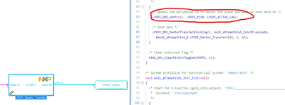

But then we investigate in generated code, we saw that NXP MBD using PCS0 as default. Every time we use the "LPSPI_Master_Transfer" block to transfer data, it will set low the PCS0, then send data.
so with the result in generated code, we are not able to communicate with multi spi slaves.
Please give us your comments on this issue. Does any other way for us to have multi spi slaves model ?

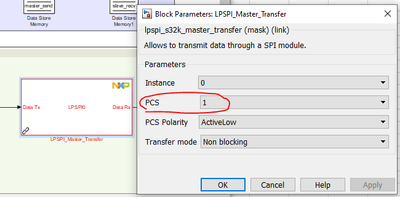

You can select which PCS to be used on each transfer from the LPSPI Master Transfer Block, the PCS dropdown.

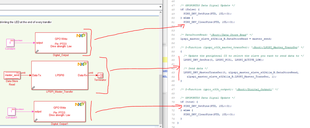

However, you can still use the S32K118 for your application. My suggestion here is to use a GPIO block for each Slave, as CS. Before the transfer, you have to clear the CS pin with the GPIO block and set the CS pin once the transfer has ended. Let me know if you want me to give you more details on that.

  /* S-Function (lpspi_s32k_master_transfer): '<S7>/LPSPI_Master_Transfer3' incorporates:
   *  Constant: '<S7>/Constant3'
    /* Update the peripheral CS to select the slave you want to send data to */
    LPSPI_DRV_SetPcs(1, LPSPI_PCS0, LPSPI_ACTIVE_LOW);
    /* Send data */
    LPSPI_DRV_MasterTransferBlocking(1, msdi_attemptViet_ConstP.pooled4,
      &msdi_attemptViet_B.LPSPI_Master_Transfer3[0], 3, 10);
we clear the GPIO which is connected to SPI slave that we want to transfer data to.
But, in the generated code above, there is the line :
does it clear the LPSPI_PCS0 pin ?
and if it does, it will impact to our hw design, because when we want transfer data to other SPI slave.
NXP MBD keep generating the " LPSPI_DRV_SetPcs(1, LPSPI_PCS0, LPSPI_ACTIVE_LOW);"
thanks

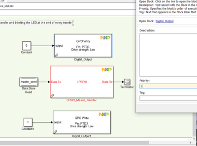

However, you have to tweak the generated code for the blocks in order to make sure that you send/receive data to/from only one slave device. You can specify the order on how the code should be generated by setting the priorities of the blocks. You can set this by right click on the block, select Properties, and set a numeric value in the Priority.
I can see in your code that when you select the PTD1 CS (pull it low) the others you pull high, to not communicate with the remaining devices, which is ok. But my suggestion is that once you end that transfer, pull the PTD1 again to high. In this way, you won't need that each time you communicate, to set the other CS pins again. See below an example.
Now, you are right regarding the CS pin selection each time in the generated code. What I would suggest is either to leave that pin unconnected, or you may also could try to select a value of 2 or 3, which of course should not be connected to any pin. However, the last idea has to be tested on the board.
