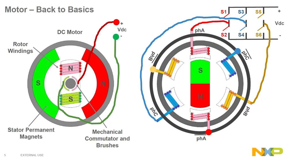

In this second lecture of the motor control course we discuss about software and hardware main components that we are going to implement and use. Starting from a comparison between DC vs. BLDC motor construction we discuss step-by-step all the key elements needed for a closed loop speed control system.
Main topics:
    - DC vs BLDC motors;

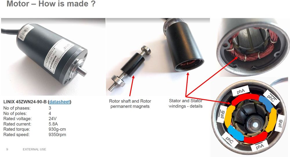

    - BLDC motor - how is made;
    - BLDC motor - how it works;

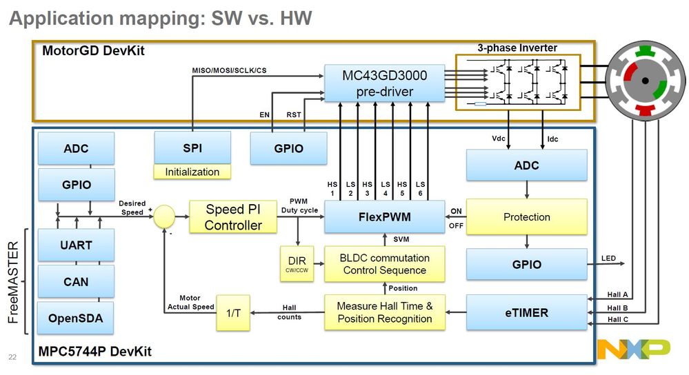

    - Block diagram for a speed control system;
    - Mapping application over the MPC5744P and MotorGD hardware components;
    - Final setup we will use for implementing the control algorithms;
