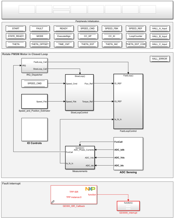

I am also facing a similar issue. I have installed all the required toolboxes. MBD toolbox S32k3 and also MBD toolbox S32k1xx. Also, I have installed the support packages for this. In the Model-based development lecture on the NXP website, I downloaded the Simulink file "M7.Zip" from the MBD-Torque control topic. I am working on a project of FOC control for the PMSM motor. When I opened this file in my MATLAB version R2022b its not showing all the details. It's giving the "Unresolved Link" error message. Please tell me what the issue is. I am attaching the screenshot of that model below.

Hi @AKA94 ,
Thank you for using the latest NXP Model-Based Design Toolbox for S32K1xx MCUs - version 4.3.0 - NXP Community
Unfortunately the M7.zip part of the course Module 7: Torque Control - NXP Community was released in a previous version S32K 2018.R1 for the S32K1xx family.
That is why, when opening the model you will see missing links:
My advice is to use the newer model, found in the newer S32K1xx 4.3.0, in C:\MathWorks\Toolboxes\NXP_MBDToolbox_S32K1xx\S32_Examples\s32k14x\mc\PMSM_Demo\PMSM_ClosedLoop:
This model is similar to the one in the Module 7: Torque Control but it also has a few more improvements regarding the Alignment, Speed Control and GD3000 Fault implementation.

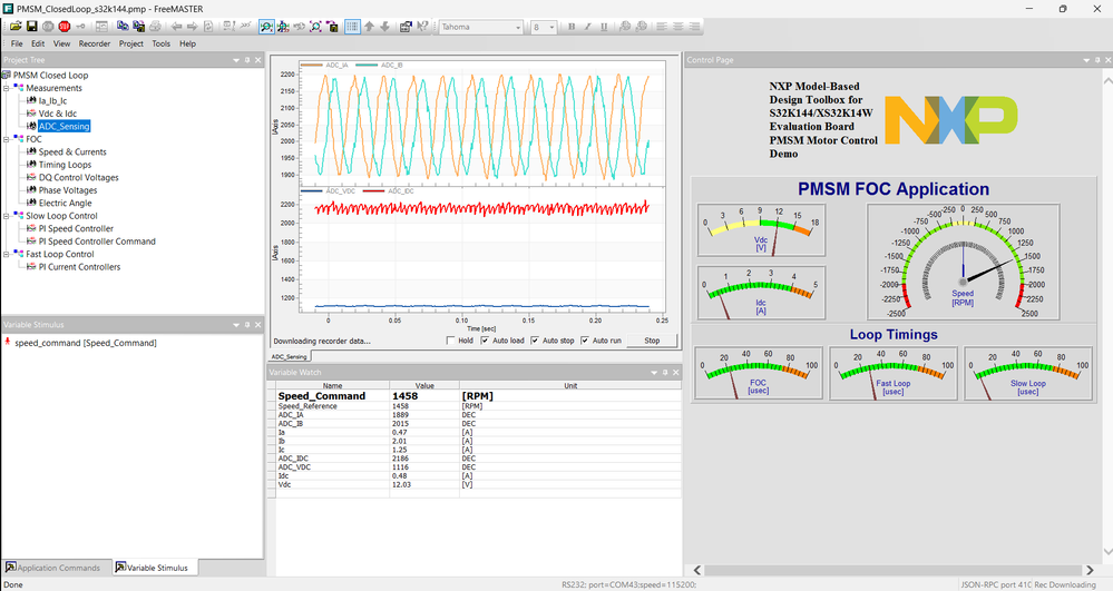

PS: I was able to build and run the model with MATLAB R2021a and R2023b, it should work also with R2022b:
PMSM_ClosedLoop_s32k144 FreeMASTER.pngPMSM_ClosedLoop_s32k144 FreeMASTER.png
