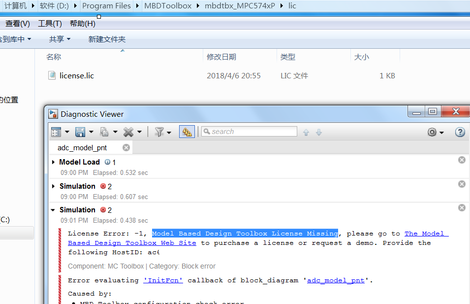

Model Based Design Toolbox License Missing
5,415 Views
jackjack
the hostID is right. I allready get the license, why would that error keeps coming up?
MPC5744P+matlab2016a+s32ds2017
4,818 Views
jackjack
i already tried this, but it doesn't work. maybe it has something to do with my driver.  i have a 128G SSD(driver C) + 500G HDD(driver D E F). matlab  and mbdt are both installed in driver D.
4,818 Views
Daniel_Popa
Hi Jack,
What is the disk serial number of the partition used for MBDT installation (in fact how many numbers does it contains)?

jackjack
4,818 Views
mariuslucianand
Hello jackjack‌,
Thank you for installing our toolbox.
If you added the license file after you ran the mbd_pnt_path.m script, please set the Matlab path to default and rerun the script (in order to include the license in path).
You can also try to change the extension from .lic to .dat.
Also, please follow this tutorial  Video Link : 7692.
Hope this helps,
Marius
