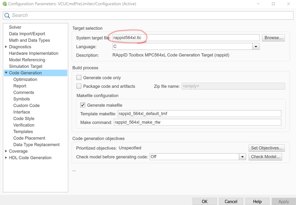

Hi All,
I am using rappid564xl (MBSD toolbox for MPC5643L) to generate code out of my Simulink model. Then I found out that once I drop the RAppID MPC564xL Target Setup in, my option for "Configure Model Functions" will disappear.

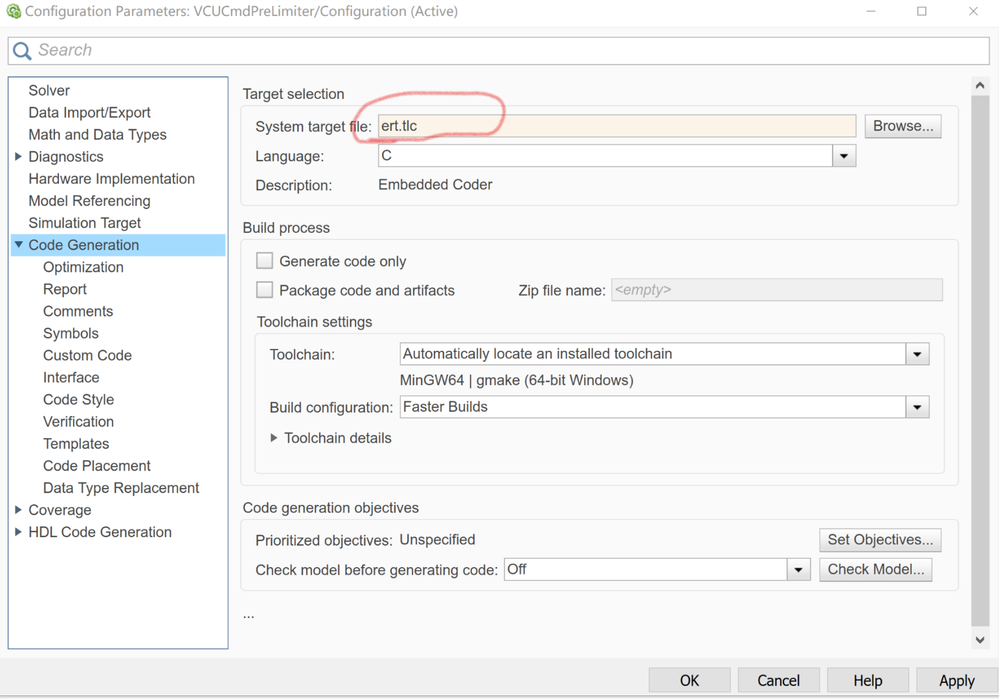

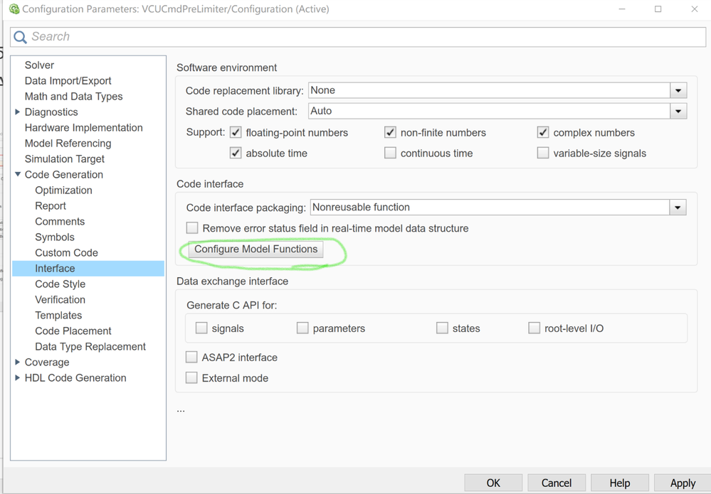

if I set system target file to ert.tlc, the configuration Model function will show up.

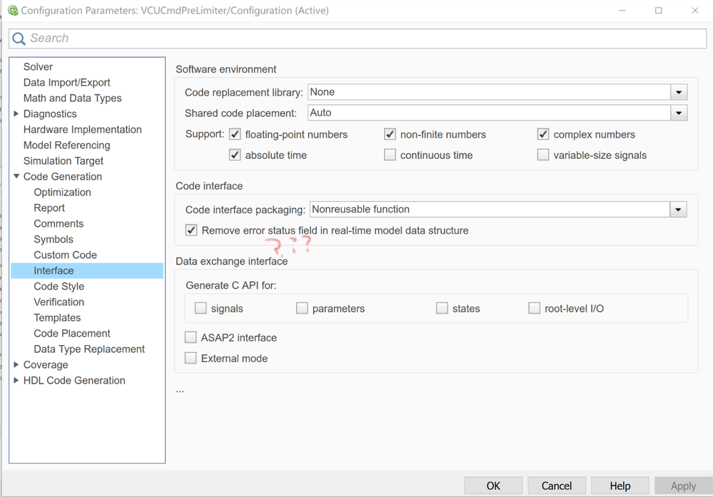

if I set system target file to rappid564xl.tlc, the configuration Model function will disappear.
Why? I wonder if NXP purposely dropped out this option when writing the system target file. Can I modify the rappid564xl.tlc to bring this option back? I think we can. Right?

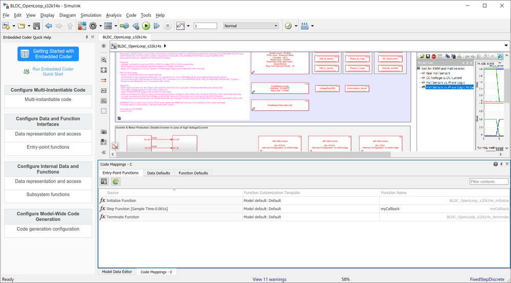

Hi yujiangwu,
Anyone figured this out? Please Help.Right now, I just want to change the name of the initialize function and step function
Things are changing in Simulink over time. Now there is an easy way to customize your code generation option.
In this particular case please use "Code Mapping Editor"
For more information please refer to: Override Default C Step Function Interface- MATLAB & Simulink Example
