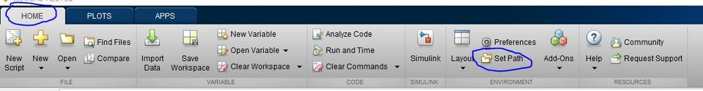

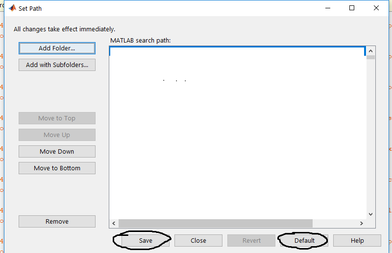

Hello [email protected]‌,
Did you have an earlier version of the toolbox installed? To be sure, can you try and reset the MATLAB path? For that you should go to MATLAB Home tab -> Set Path -> Click on Default -> Then click on Save.
and then run the mbd_mpc_path script so you install the path for the toolbox over a fresh, default MATLAB path.
Note: you will lose other paths other than the default + MPC toolbox paths by doing this. Consider saving the current  contents of your MATLAB path (you can get it by typing matlabpath in the MATLAB terminal for instance).
Note: this file is located in {INSTALL_ROOT}/src.
I'm asking this because I cannot replicate the issue you are having - but I can get an error using some older tlc files in conjunction with the new toolbox (the one that you have installed). This is the reason why I assume this to be the problem. Please let me know if this does the trick.

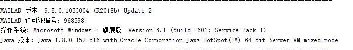

Could you confirm that you are using version 3.0.0 of our MPC toolbox? And also could you run the following command in MATLAB terminal and share the output with me?
ver
I could not reproduce your error, thus I'm thinking maybe you have files from previous version of the MPC toolbox shadowing the ones from v3.0.0.
Kind regards,
Razvan.

260068845
Hello,constantinrazvan.chivu‌
   I sure the version of the MPC toolbox is v3.00.

3,233 Views
260068845
Helloconstantinrazvan.chivu‌,
      According to your method,I can build my model successfully. Thank you very much.
