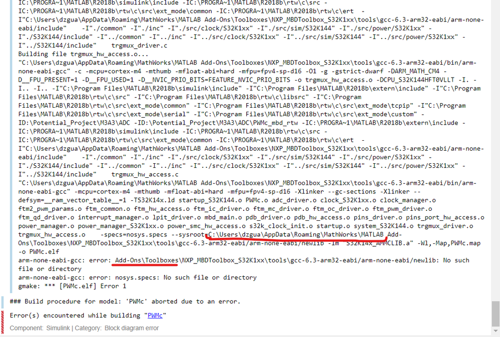

I use Matlab 2018b with MBD Toolbox generate code, but I meet a question shown as below.
https://nxpcommunity.force.com/community/servlet/servlet.FileDownload?retURL=%2Fcommunity%2Fapex%2FCommunityNXPCaseDetail%3FcaseId%3D5002p0000250K23AAE&file=00P2p000038fmdAEAQ&_CONFIRMATIONTOKEN=VmpFPSxNakF4T1Mwd05DMHhPVlF3TmpvMU5Eb3dPUzQ1TWpoYSxBX1NUN25mYWoweW4wS2ZjSFFoWnBmLE1HWmtNekV4&common.udd.actions.ActionsUtilORIG_URI=%2Fcommunity%2Fservlet%2Fservlet.FileDownload
And the IAR I use is IAR 8.32 for ARM, when I add the generate files into the IAR project, I build the project, the IDE report errors shown as below.
https://nxpcommunity.force.com/community/servlet/servlet.FileDownload?retURL=%2Fcommunity%2Fapex%2FCommunityNXPCaseDetail%3FcaseId%3D5002p0000250K23AAE&file=00P2p000038fmdtEAA&_CONFIRMATIONTOKEN=VmpFPSxNakF4T1Mwd05DMHhPVlF3TmpvMU5Eb3dPUzQ1TWpKYSxnTTVOcHNMUzBlSmZCS1NZc3pwSTNkLE1HWmtNekV4&common.udd.actions.ActionsUtilORIG_URI=%2Fcommunity%2Fservlet%2Fservlet.FileDownload

constantinrazva
Hello cg0‌,
In the IAR embedded workbench you have to also include the linker files (.icf) and make sure you don't use a default linker file instead. Those symbols (__VECTOR_TABLE, __VECTOR_RAM, etc.) are defined there - this is why it does not compile.
As for your other issue, I'll have to install your version of the compiler and test it. Do you have the latest patch installed ? (The one available here) - I'm asking to have a clear picture of your environment so I can replicate your issue.
Could you also post the output of the following command ran in MATLAB terminal?
ver
Kind regards,
Razvan.

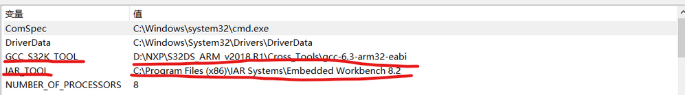

cg0
Hi Constantin
Sorry for waste your time.
I already know why this two problems occur, and have already solve them. both due to the environment variables not set correctly.
For the IAR as compiler error question, beacuse of the compiler environmental variables didn't set correctly. And Now I set can got the right result.
For GCC, Firstly I use the matlab package gcc address as environment variables,  and I found when matlab use "arm-none-eabi-gcc" it seems lost the prefix of the full address linker.  Then I change the GCC environment variables to S32 DS files, it works normal.
Thank you.
