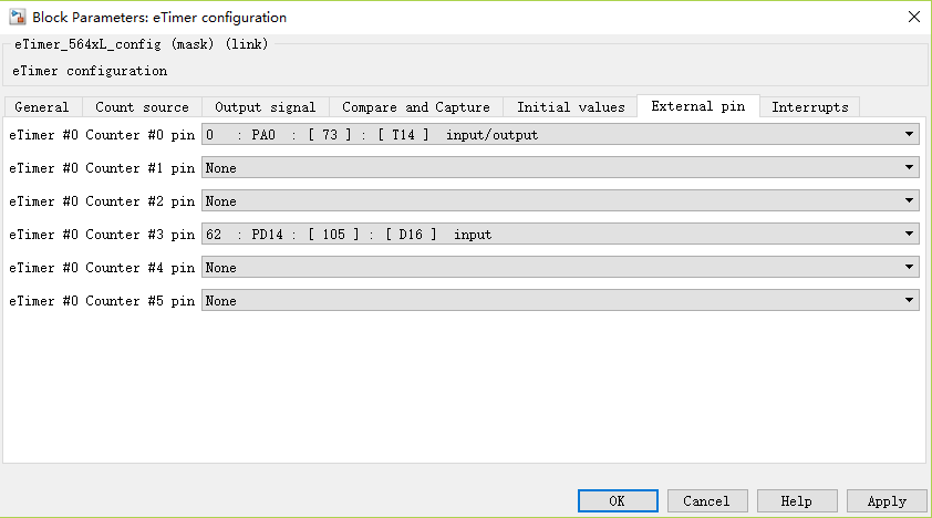

Hi everyone,
  Today,I copy the etimer_capture from MPC5643L example.Then I down the example to the trk-usb5643l,the example work well.Then I modify the etimer counter pin.

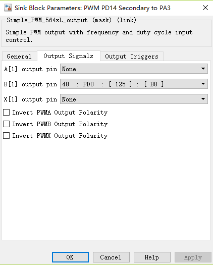

In the example

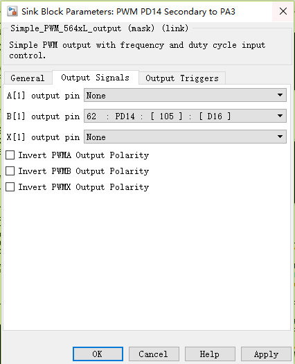

After I modify
Then I download the program to the trk-usb5643l,connect the PD14 with PD0.In the Freemaster,I see the 'PulseWidthmks' always zero.
I want to now how to modify can make the program work well.

Hello hongjinzeng‌,
Sorry for our delayed answer.
We reproduce the problem and we are now working on solving this.
Marius
