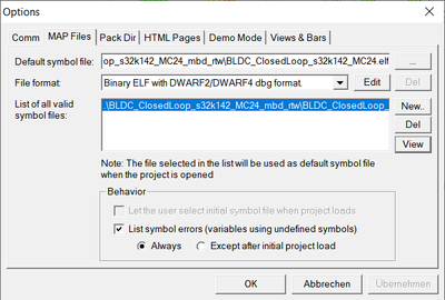

I have a MCSXTE2BK142 board. I am able to program it with the MBDT over the serial connection afer I flashed the S32K142_S32DS_UART0_CAN0.rbf file.

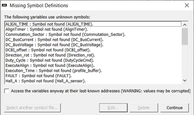

I want to use the example project "BLDC_ClosedLoop". I sucessfully connected the board in Freemaster with the Connection Wizard over the serial connection with a baud rate of 115200. But I am not able to control the Board. Maybe this is because there are missing symbol definitions.

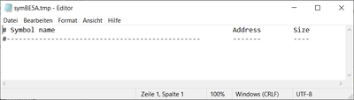

According to this Answer there is no TSA available, so the definitions are missing. But the .elf file of the project does not contain any symbol:
Because there are no symbol definitions, I am not able to control anything. Additionally I can not look up any measurements (e.g. hall sensor state) of the board.

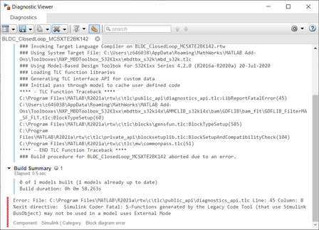

Furthermore I am not able to use the external mode in the "BLDC_ClosedLoop" project. If I set up everything and disable the Freemaster Configuration and Recorder, while building ("Build for monitoring") I get this error:
Is it not common to use the board in external mode so that you can control and debug the board from Matlab? What is my error here?

We don't offer support for TSA with MBDT, but the loading of the ".elf" file should fix your problem.
Please delete all generated files by the build process, then try to build again the project. After that open, the FreeMaster project, do not hit the connect button yet, then load the newly generated ".elf" file and see if there are some missing symbols. If there are no missing symbols, try to connect the FreeMaster project to the development board.

Hello @E_S ,
Please tell me which version of Matlab do you use and after building the project, open the ".map" file with a text editor and see if there is anything.

4,378 Views
E_S
Hello Adrian,
Thank you for the fast response.
I use Matlab R2021a.
The ".map" file is filled.

4,342 Views
E_S
Hi Adrian,
Thanks a lot. Now it works nice with Freemaster.
Is it possible to use the example in external mode of Matlab and solve the problem I mentioned above?
4,329 Views
adriantudor
Hello @E_S ,
It won't work with the external mode of Matlab (that has its own protocol) because the FreeMaster block generates the driver code that takes care of all functionalities of FreeMaster (data handling, data record, transport data over the serial interface, etc).
