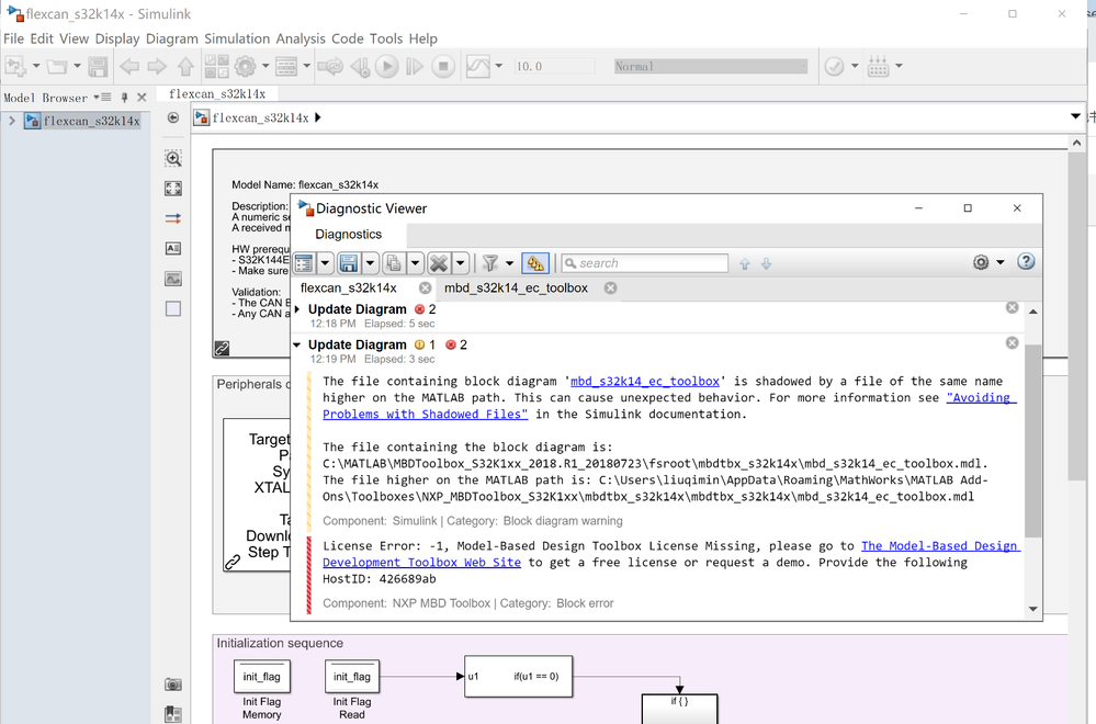

Hello:
After S32K1xx MBDToolbox installing, i'm runing a demo model, but get a lincense error message as following:
according to this message ,as if the matlab can not find the lincense file.but the lincense file have been put in the folder as following show.

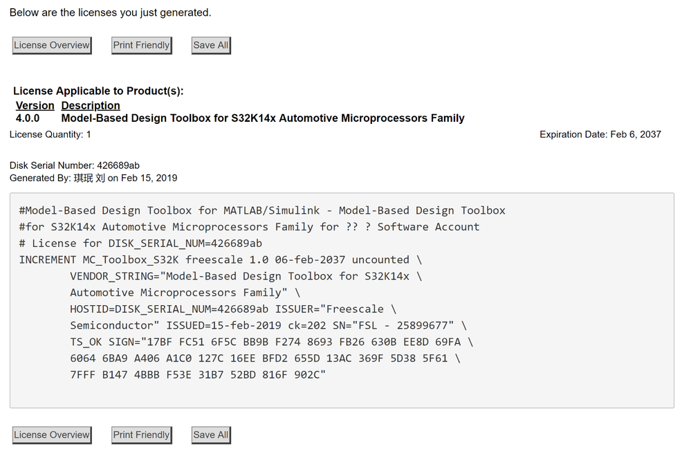

My lincense file generated as following.
What's wrong for installing?

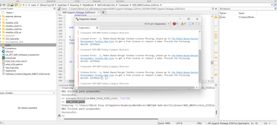

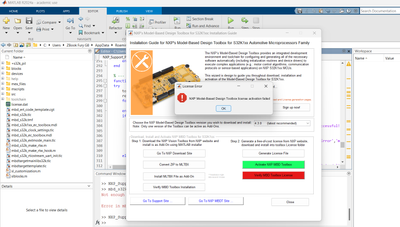

 i am using MATLAB 2024a and trying to install the nxp tool box and on all the tries i am pulled to this error i have tried all the things mentioned in this thread
jaisreedhar_1-1717655989518.pngjaisreedhar_1-1717655989518.pngjaisreedhar_2-1717656030244.pngjaisreedhar_2-1717656030244.png
running the command  winopen(fullfile(mbd_find_s32k_root, 'lic'))
shows the .dat file in the correct location
