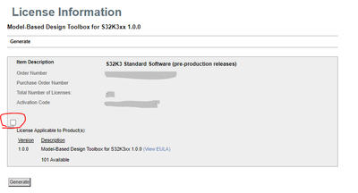

hayaoki7
Hello marius,
There is no checkbox for license selection. Therefore, a warning will be displayed if it cannot be generated.
Best regards hayaoki7

@hayaoki7 ,
That's strange. Let's follow the steps below.

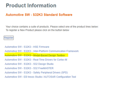

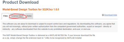

1. Go to this link: https://www.nxp.com/webapp/swlicensing/sso/downloadSoftware.sp?catid=SW32K3-STDSW-D
2. Select the Automotive SW - S32K3 - Model-Based Design Toolbox
3. Select this one
4. Select the License Keys tab
5. The following options should appear
Now, you have most likely followed the steps above, but wanted to check the source from step 1 if it is working or not.
Otherwise, please send me a screenshot from step 5 from your side, and I will try to contact the licensing administrator.

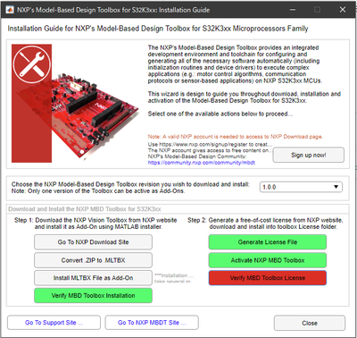

Looking at the license tab, there was a checkbox for S32K3. I have generated a license. However, it cannot be built yet.
It is an error display.
License Error: -5, Model-Based Design Toolbox License Invalid, please go to The Model-Based Design Development Toolbox Web Site and include error number.
The MBD installation is successful.
>> mbd_s32k3_path
Treating 'C:\Users\H\Documents\MATLAB\Add-Ons\Toolboxes\NXP_MBDToolbox_S32K3xx' as MBD Toolbox installation root.
MBD Toolbox path prepended.
Registering the toolchain ...
Successful.
Best regards Hayaoki7

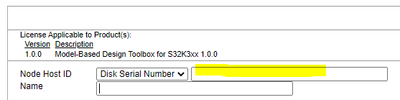

mariuslucianand
@hayaoki7 ,
It looks like the license file is invalid.
When you generate the license, you have to type the Disk Number in the yellow area.
To find the disk number you have to type in a Windows Command Prompt the vol command.mariuslucianand_1-1637056773914.pngmariuslucianand_1-1637056773914.png

hayaoki7
Hello Marius,
You are entering what is displayed in VOL. I generated the license several times and tried it with that file, but I couldn't build it.Is it because it is a pre-release version?
8,024件の閲覧回数

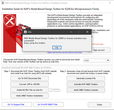

hayaoki7
Hello Marius,
In addition, I've generated license files several times since then. Succeeded. Thank you very much.
