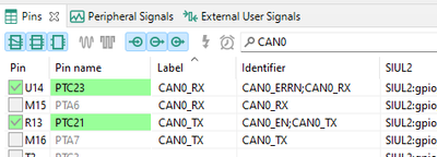

Rx/Tx pins are set as in the board user guide (PTC23: Rx / PTC21 : Tx)

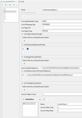

I have some CanHardwareObjects set as receiver with Id filtering disabled (Filter mask 0 = accept all frames)
2025-03-05 09_36_20-_Peripherals - s32k37x_s32k39x_can_receive_s3... (S32K396, Cortex-M7 (Core #0)) .png
Can someone help with this ?

Could you please try and send frames with EXTENDED Id option enabled inside your Can analyzer software and let us know if this works?
From what I am noticing from the configuration project, all the Receive hardware objects are configured with Can ID Message Type set as EXTENDED. For being also to also receive STANDARD frames, you should change the option to STANDARD.

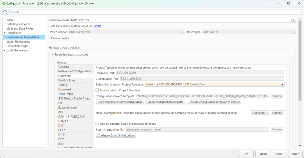

I have tried it on my own setup, and I managed to receive CAN messages from my CAN analyzer. Could you please check if you have selected the BGA-DC1 configuration in your model, like illustrated below?
The reason why the LED is not blinking could be related to the fact that, on the BGA-DC1, the pin routed to the D33 BLUE LED is different than the one configured in the default configuration project that we provide for the S32K396 processor.
Changing the Configuration Project Template to address the DC1 board might solve the issue you are currently encountering.
Please let us know if this helps,
Irina

I confirm that i'm using the same Configuration Project Template

Vincent_91687
Hello Irina,
It works !
Thank you for the link, this is very helpful.

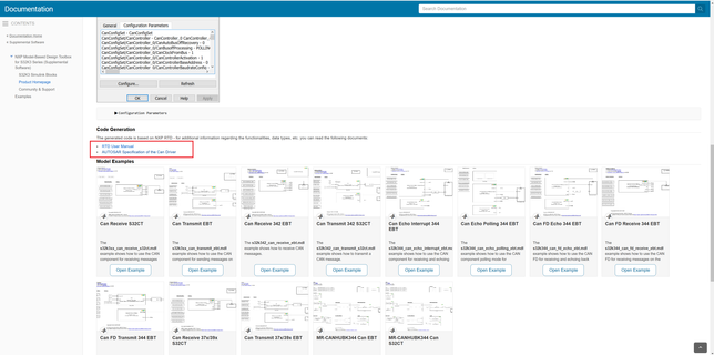

MBDT integrates the RTD (Real-Time Drivers) for configuration and access to the hardware (peripherals, pins, clocks, interrupts). For more details on configuration parameters, and functions implemented by our blocks, you could check the RTD User Manual for the component you would like to use, and also the AUTOSAR driver standard (RTD MCAL layer is AUTOSAR compatible).
For CAN, and other blocks as well, you could access this documentation I am referring to by clicking on the Help button of the Simulink block, and navigating to the Code Generation section, like illustrated below.
For configuration examples, you could check the configuration projects that we are delivering together with our application examples.
Moreover, in case of the ADC, PWM, CAN, UART and DIO, we have also put together some articles on our MBDT NXP Community, that provide a more detailed insight into the available parameters, and settings. Maybe you would find them useful as well. Here is the link to the CAN one, but the others are available under the Beginner's Guide for Model-Based Design Toolbox section on our main page.
