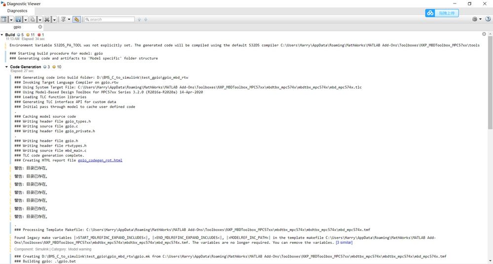

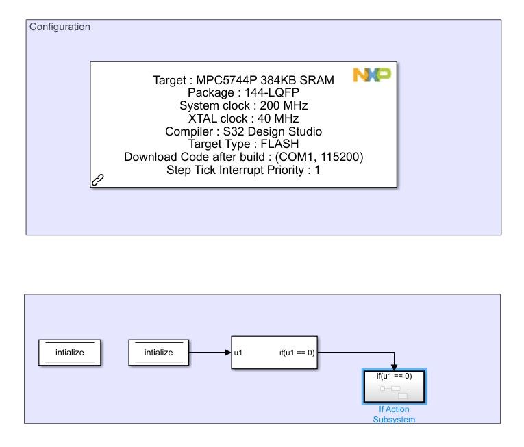

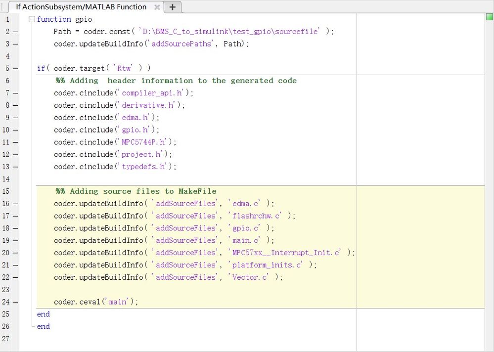

      I am going to develop a Battery Manage System. I will use MPC5744P and MC33771C and I want to use the MBD method. I have download the MC33771C driver from the NXP website, I need to import the C code to the Simulink model.
      So, I made some attempts. The Hardware is the DEVKIT-MPC5744P, the C code is the hello world program in the S32DS library. when I build the model, I got some error message.
       I attached the program file. Hope someone can help me, thank you.
