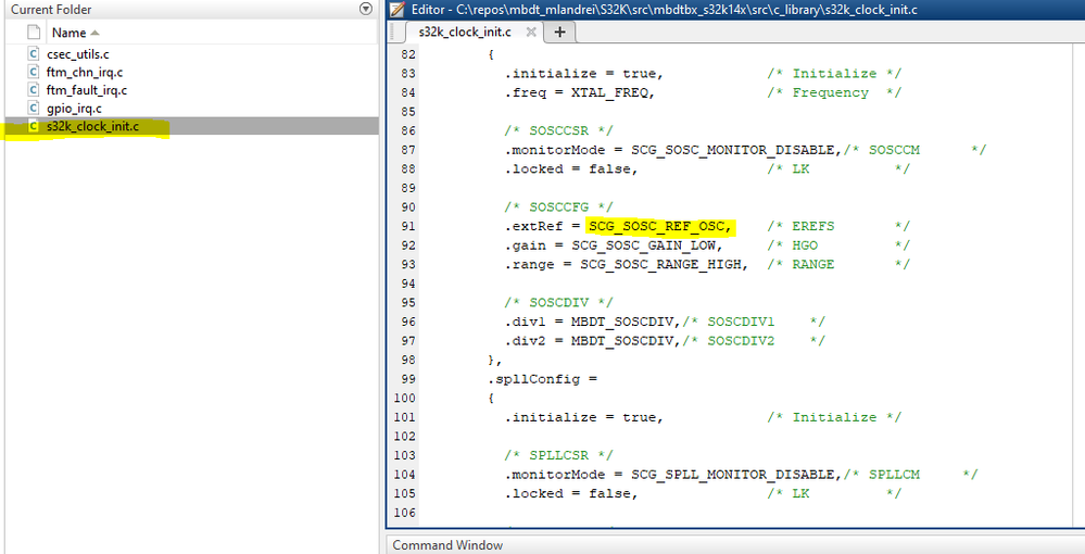

Using : MBDToolbox 4.2.1,with hotfix for register access blocks.
Using: S32K144 LQFP-100, on proprietary hardware board
The dropdown box for XTAL Frequency does not display the option to use the onboard oscillator module; the "External 8" option misleadingly suggests it is for an external oscillator, but actually configures the onboard oscillator module.
When the block is configured as "External 8", the following code is generated in the s32k_clock_init.c file:
.soscConfig =
.initialize = true, /* Initialize */
.freq = XTAL_FREQ, /* Frequency */
/* SOSCCSR */
.monitorMode = SCG_SOSC_MONITOR_DISABLE,/* SOSCCM */
.locked = false, /* LK */
/* SOSCCFG */
.extRef = SCG_SOSC_REF_OSC, /* EREFS */
.gain = SCG_SOSC_GAIN_LOW, /* HGO */
.range = SCG_SOSC_RANGE_HIGH, /* RANGE */
/* SOSCDIV */
.div1 = MBDT_SOSCDIV,/* SOSCDIV1 */
.div2 = MBDT_SOSCDIV,/* SOSCDIV2 */
This configures the SOSC module with EREFS=1,  which selects the internal oscillator amplifier module as the source of the clock (instead of the external reference clock on pin EXTAL).

Hello @glenndoiron,
The default configuration provided in the MBDT toolbox targets the Evaluation boards delivered by NXP.
Luckily, this default configuration could be easily adapted to generate code for your particular setup. In your case, you could change the s32k_clock_init.c file from the sources of our toolbox. This file is always copied when the code is generated from the toolbox sources. What you could do is to type the following command in MATLAB Command Window: cd(fullfile(mbd_find_s32k_root, 'mbdtbx_s32k14x\src\c_library'))
Here, you could  modify the extRef clock, EREFS value from SCG_SOSC_REF_OSC  into SCG_SOSC_REF_EXT
