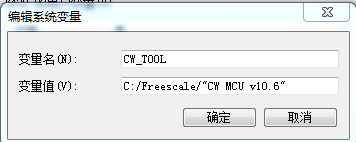

Hi daniel:
when I build the model S12ZVM_TrapCtrl download from NXP website. diagnostic view report following error ,could you tell me how to solve this problem? thanks.
my system environment variable set like this
==== Removing object files from build directory ==== Copying necessary files to build directory... Compiler details : "C:/Freescale/"CW MCU v10.6" /MCU/S12lisa_Tools/Build_Tools/mwccs12lisa" -c -model small -bfield_lsbit_first -bfield_reduce_type -opt level=0 -opt space -Cpp_Exceptions off -char unsigned -msgstyle parseable -sym full -nostdinc -nosyspath -o SetupFiles -I. -I.. -IC:\Users\E430\Desktop\MBD\S12ZVM_TrapCtrl\TrapCtrl -IC:\PROGRA~1\MATLAB\R2017b\simulink\include\sf_runtime -IC:\Users\E430\Desktop\MBD\S12ZVM_TrapCtrl\TrapCtrl\S12ZVM_Trap_Ctrl_mcd_rtw -I"C:\Program Files\MATLAB\R2017b\simulink\include" -I"C:\Program Files\MATLAB\R2017b\extern\include" -I"C:\Program Files\MATLAB\R2017b\rtw\c\src" -I"C:\Program Files\MATLAB\R2017b\rtw\c\libsrc" -I"C:\Program Files\MATLAB\R2017b\rtw\c\src\ext_mode\common" -I"C:\Program Files\MATLAB\R2017b\rtw\c\src\ext_mode\tcpip" -I"C:\Program Files\MATLAB\R2017b\rtw\c\src\ext_mode\serial" -I"C:\Program Files\MATLAB\R2017b\rtw\c\src\ext_mode\custom" -I"C:/Freescale/"CW MCU v10.6" \MCU\S12lisa_Support\s12lisac\include" -DUSE_RTMODEL -DMODEL=S12ZVM_Trap_Ctrl -DREAL_T=float -DRT -DNUMST=1 -DTID01EQ=0 -DNCSTATES=0 -DMT=0 -DHAVESTDIO Assembler details : Building file S12ZVM_Trap_Ctrl.o... "C:/Freescale/"CW MCU v10.6" /MCU/S12lisa_Tools/Build_Tools/mwccs12lisa" -c -model small -bfield_lsbit_first -bfield_reduce_type -opt level=0 -opt space -Cpp_Exceptions off -char unsigned -msgstyle parseable -sym full -nostdinc -nosyspath -o S12ZVM_Trap_Ctrl.o -I. -I.. -IC:\Users\E430\Desktop\MBD\S12ZVM_TrapCtrl\TrapCtrl -IC:\PROGRA~1\MATLAB\R2017b\simulink\include\sf_runtime -IC:\Users\E430\Desktop\MBD\S12ZVM_TrapCtrl\TrapCtrl\S12ZVM_Trap_Ctrl_mcd_rtw -I"C:\Program Files\MATLAB\R2017b\simulink\include" -I"C:\Program Files\MATLAB\R2017b\extern\include" -I"C:\Program Files\MATLAB\R2017b\rtw\c\src" -I"C:\Program Files\MATLAB\R2017b\rtw\c\libsrc" -I"C:\Program Files\MATLAB\R2017b\rtw\c\src\ext_mode\common" -I"C:\Program Files\MATLAB\R2017b\rtw\c\src\ext_mode\tcpip" -I"C:\Program Files\MATLAB\R2017b\rtw\c\src\ext_mode\serial" -I"C:\Program Files\MATLAB\R2017b\rtw\c\src\ext_mode\custom" -I"C:/Freescale/"CW MCU v10.6" \MCU\S12lisa_Support\s12lisac\include" -DUSE_RTMODEL -DMODEL=S12ZVM_Trap_Ctrl -DREAL_T=float -DRT -DNUMST=1 -DTID01EQ=0 -DNCSTATES=0 -DMT=0 -DHAVESTDIO S12ZVM_Trap_Ctrl.c '"C:/Freescale/"CW' Not an internal or external command, nor a runnable program or batch file。 gmake: *** [S12ZVM_Trap_Ctrl.o] Error 1 ### Creating HTML report file S12ZVM_Trap_Ctrl_codegen_rpt.html
### Build procedure for model: 'S12ZVM_Trap_Ctrl' aborted due to an error.

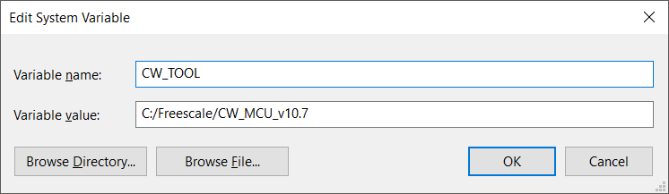

Hi David,
Here is my working setup.
Basically, I've renamed the CW folder to avoid empty spaces in the name.
Hope this helps!

dmeng1
Hi Daniel:
Thanks very much , I have success follow your help .thanks
