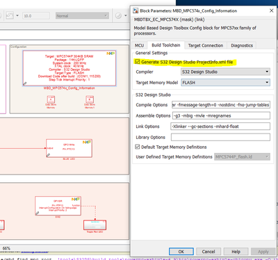

How to generate XML file out of simulink-based model to build it using s32 ?
I'm using MBDT for MPC57xx Series Version  3.2.0
1,695 Views
mariuslucianand
Hello @abdelrhman ,
The ProjectInfo.xml file is automatically generated if the checkbox from the MPC574x_Config block is checked as in the screenshot below.
As additional step, you have to rename the .S files into .s file extensions and to also change is inside the .xml generated file.
You shall use the S32DS for Power Architecture V2.1.

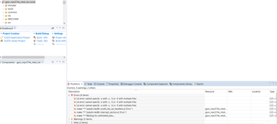

abdelrhman
I tried to import the xml file of gpio_mpc574x MBD model and built the project using s32, but I got the following errors
