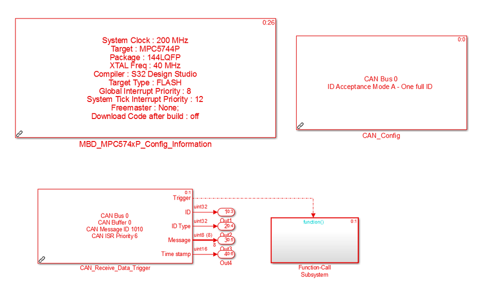

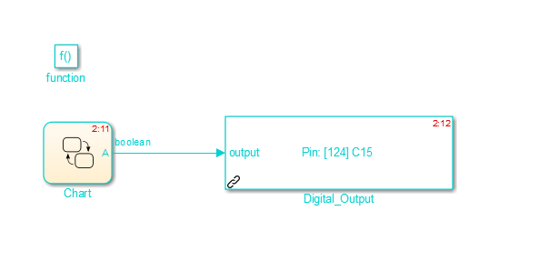

Hi all,
   I used MBD mpc5744 to create a can receive model,my trigger function is to make a Led bright. I can receive model send can data, but the can receive interruput does not work.The following is my model.

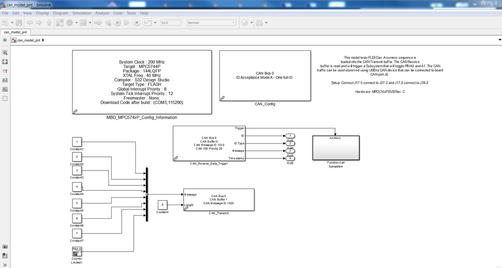

Have you tried the example shipped with the Model Based Design for MPC5744P ?
The example/demo is doing the exact same thing with what you want and can be found here: {MBDToolbox Install dir}\mbdtbx_MPC574xP\mbdtbx_pnt\Examples\can_model_pnt.mdl
Please give it a try and let us know if this works. If the demo works then most likely there is a configuration issue in your model - and you could use this demo as a starting point.
Hope this will resolve your issue.

  This demo can work properly,Thank you very much for your reply!
