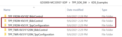

Currently, I am using MC33937 in my application. I saw mbdt of mcp57xx supporting MC33937, but in KVx series I don't see anything related with mc33937.

nxa11767
Hello @CauTran ,
Unfortunately the kinetis toolbox does not have the blocks to support the integration with MC33937.
You can use custom code blocks  -  If you get the software drivers from the NXP site. You can find there examples for KV3x MCU, with the configuration and initialization part done (the projects can be imported in MCUXpresso IDE), and you can start from there.
You can try to migrate first the KV31F TPPConfiguration to run on KV5 (pin settings in board/pin_mux.c)

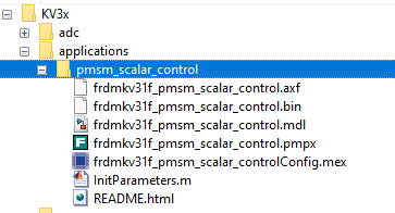

For the current version, can you give me the example for motor control?
We already deliver a PMSM application for the KV3. Of course in the External Configuration Tool the MCU has to be changed and also the pins have to be matched for your MCU part.
