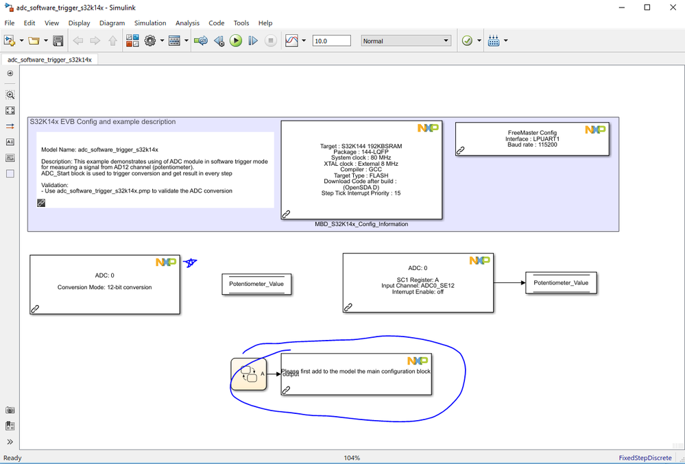

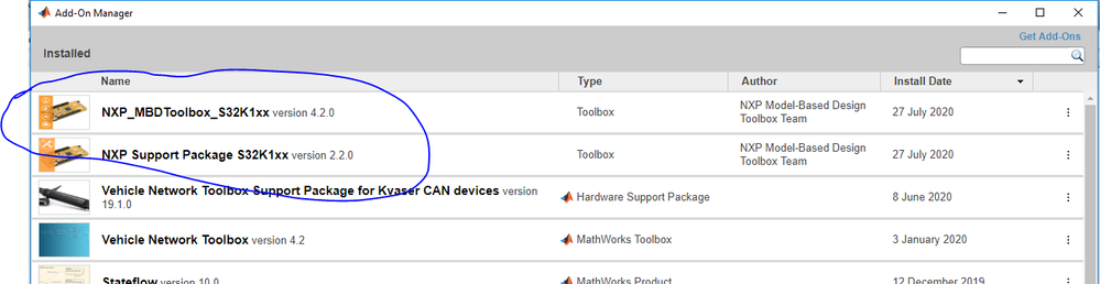

I'm having an issue with version 4.2.0 toolbox for S32K processor.
Versions:
  • Matlab R2019a
  • Windows 10
  • MBDT:  4.2.0
View from Matlab Add-on Manager:
Issue Description:
When I load an example, some blocks require additional information reference to function.
An example is circled below:

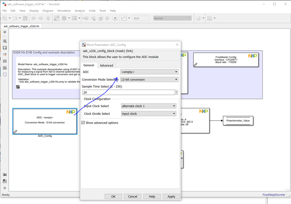

When I click on ADC_Config block (starred above), the drop down for selecting ADC is not populated and I cannot select the ADC to configure it, figure below:
NOTE:  This is also true for other examples, such as CAN comms.
Please let me know what is missing!

Hello andrewweiss ,
There might be some conflicts still from the previous version - I would recommend you do the following, in the MATLAB terminal, for resetting your paths:
restoredefaultpath;
mbd_s32k_path;
Note: before you run the 2nd command, you should go to the root folder of our toolbox (that script will be there).
Please let me know if this fixes your issue.
Kind regards,
Razvan.
3,874 Views
andrewweiss
Thanks!   This helped and corrected the issue.  This problem is reolved.

andrewweiss
Yes, but I have had version 4.1 install previously.
Here is the output of the "ver" within Matlab:
