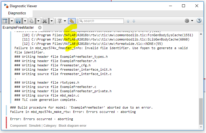

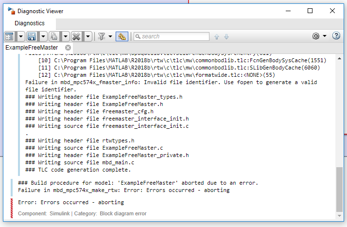

I am using the DEVKIT MPC5744P with Model-Based Design Toolbox for MPC57xx Version 3.0.0
and I can not build the model with freemaster block.
Can you help me with this issue?
Please see the example model attached.

rafael_barbosa
Dear mariuslucianandrei‌
Please see the log attached.
Kind Regards, Rafael

mariuslucianand
Hello [email protected]‌,
When the code for the FreeMaster is generated, it has to find the address for the peripheral that is going to be used. for communication. So the program reads the address from a file that can be found here {AddOn Instalation Folder}\MPC_Platform_SDK\platform\devices\MPC5744P\include\MPC5744P.h
Now can you please check if the file exists, or if an application keeps this file in use? Because as far as I understand, the toolbox is not able to open this file.
Related to the latest version 3.2.0 what kind of error have you encountered? Installation, running or the models developed in the 3.0.0 were not able to run correctly with the 3.2.0?
Hope this helps,
Marius

rafael_barbosa
Hello mariuslucianandrei,
Yes, the MPC5744P.h existis in the related toolbox folder.
I can build others models that does not have the Freemaster block.
Regarding the erros with the 3.2.0, from what I remember, there were build errors when generating the code.
Kind regards, Rafael

mariuslucianand
Since I can not reproduce the mentioned behavior on my machine, and I believe that there is an app or something that is keeping the .h file from being opened by the FreeMaster scripts in Matlab, I will send you a patch for 3.0.0, only this time, that will work only on your machine. These files are not suitable for other MBDT versions, only for your installed MBDT for MC57xx version 3.0.0 which is obsolete. We strongly encourage our users to keep their toolboxes updated with our latest releases. And since we mentioned that, I am very interested to see the errors you got using our last MBDT for MPC 3.2.0.
So, I will ask you first to backup the original files you have in  the 3.0.0 and replace the files as follows:
mbdtbx_mpc574x\mbdtbx_mpc574x\blocks\fm\fm_mpc574x_config.tlc
mbdtbx_mpc574x\mbdtbx_mpc574x\mscripts\fm\mbd_mpc574x_fmaster_info.p
What this patch does, it avoids opening the .hrequired file and includes a dependency in the FreeMaster source files.
I hope this solves for now the issue!
Marius

rafael_barbosa
Hello mariuslucianandrei‌,
Indeed these files solved the problem.
Thank you very much!!
