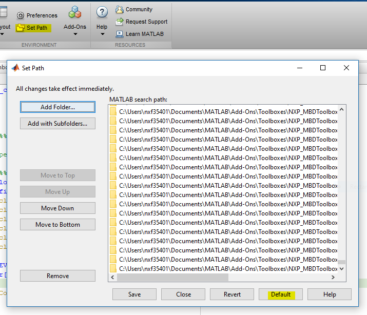

mariuslucianand
Hello [email protected]‌,
Have you installed the 2018.R1 over the last MBDT version?
Please reset the Matlab "Set Path" to "Default" like in the attached image and then perform a clean install of the MBDT 2018.R1.
Marius

mariuslucianand
I assumed that you used the old toolbox version before and the files from the last toolbox version were still in the Matlab's path. So with a clean install I want to be sure that the only files related with the MBDT toolbox are the ones from the current toolbox.
Now, you set the paths to default, go to the Addons folder which typically is C:\Users\[...]\Documents\MATLAB\Add-Ons and in the MBDT toolbox please run the "mbd_s32k_path.m" script.
Now, if you type the command "ver" in the Matlab Command Window, you need to be sure that you have only one toolbox related with S32K. For example I only have this "Model-Based Design Toolbox for S32K1xx Series         Version 2018.R1     (R2016b-R2018a)".
Hope this helps,
