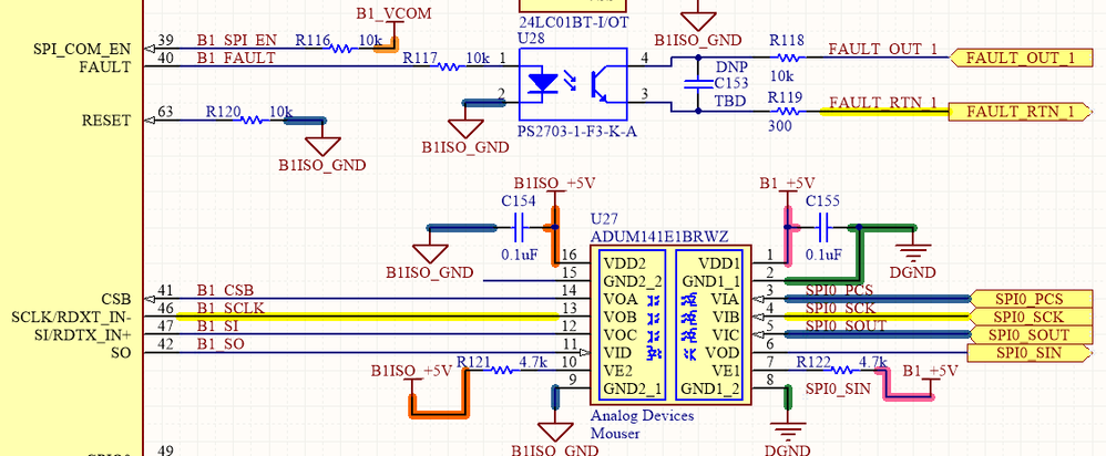

Dear @mariuslucianand
I have a question regarding configuration the MC33771B blocks.
I have the S32K144 with x3 SPI connected to x3 chipset of MC33771B via difference SPI 0~2.
When I tried to config to intialize this  BCC config.
It is only allowed for single-block.
Can you help advise me how to config the MDBT to communicate with 3-SPI
(3-Chipsets of MC33771B independently)
Thank you,

Narudol-T
Because we have prior reason regard communication that we must using CAN Bus for stability.
In order to reduce cost, the SPI with multiple BCC will be the best options for us at the moment.
Unfortunately, our team already proceed the hardware to sample B2 level.
We are using SPI isolator chip x3pcs from Analog devices to separate the ground.
Since the customer's usage application may reach at 1,415Vdc.
So we already consider the BCC to be isolated grounding in every BCCs,
If you may look at below hardware, the above area are BCC x3 sets (42cells)
and coming after with Isolators (LED, SPI, Power Supplies) x3sets.
And then S32K144 with comm ports x3CAN & x1RS485.
Can you help how should I modify the software to get this hardware working for x3-SPI?

mariuslucianand
Hello @Narudol-T ,
Thank you for sharing part of your design with us! It looks pretty cool and you have a very nice design there!
So you have already foreseen the GND problem and you have isolated each BCC on the MCU using ADUMs.
I have one more question before analyzing the options and recommend the one that will fit your needs the best: I've seen in the attached schematic how it looks for the B1. Have you connected all of them to the same SPI0 instance and have assigned one ChipSelect signal for each BCC (B1 - SPI0/CS0, B2 - SPI0/CS1, B3 - SPI0/CS2)? Or have you assigned one entire SPI instance for each BCC? Basically (B1 - SPI0, B2 - SPI1, B3 - SPI2)

Narudol-T
We before once want to use single SPI for x3 BCCs.
however, when we digged down into schematics design.
we found that the supply power of SPI isolator chip  will be common ground which lead to isolation problem.
so we need to allocate separated SPI one for each BCC with totally separated power supplies.
