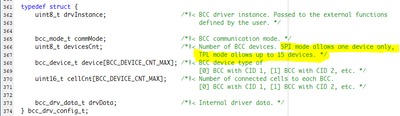

I've made an analysis based on the information you've provided and as I've told you in my first reply, the current approach of code generation in MBDT only allows you to have one device connected over the SPI or up to 15 connected over TPL.
MBDT generates code on top of the MC3377xB driver and here, the main Driver configuration uses the bcc_drv_config_t structure type which keeps the state only for one device in SPI mode.
Now, the MBDT MC3377xB_Config_Block generates only one structure in each model, so from here comes the limitation. If it were to support more devices over SPI, we would have to generate this for every block. We designed such blocks considering that if an application would use more BCCs than one it will use the TPL approach.
Now, your approach is not impossible and obviously, it can be achieved in MBDT but requires an important amount of changes in the current implementation, which can not be provided via a simple HotFix to you. Basically, you request here a new feature.
