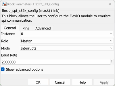

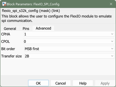

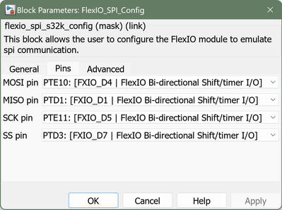

Hi all, I have a PCB with a S32K148 and a UJA1169ATK. The UJA is connected to the FlexIO pins for SPI as all 3 normal instances are used for TPL communication.
I am having isses getting the UJA to respond properly so I was wondering if the integrated blockset can be used with Flex SPI so that I can eleminate any arrors I am introducing by sending it manually?
Here is my model and configuration. For some reason in this I only ever get 0x0000 returned from the FlexIO SPI bus. Weirdly, if I change my SS to PTD3 but on FXIO_5 which conflicts with PTE11 SCLK then I get 0x7E00 returned rather than nothing, this is confusing!
Any ideas would be greatly appreciated!
