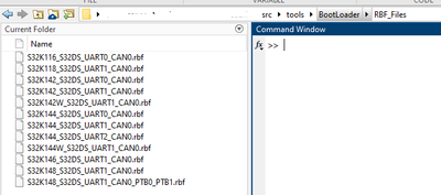

In the files delivered with our toolbox, under tools/BootLoader/RBF_Files you can find many sources of bootloader for all the evaluation boards NXP provides for the S32K family. We are only using and redistributing the RAppID bootloader utility and there is another team responsible for this product. I've seen as well the mentioned archive and I think is a good start for your project.

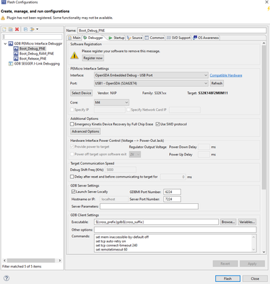

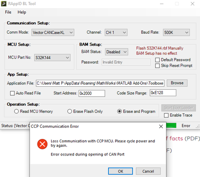

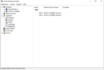

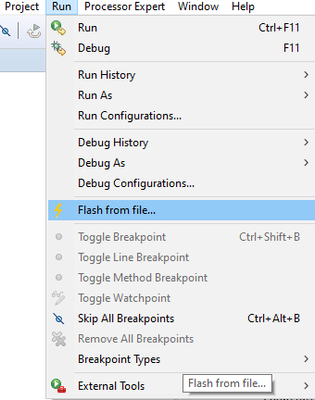

I saw on some posts that RAppID workd with s32k148 when you flash the .rbf that is included: "S32K148_S32DS_UART1_CAN0.rbf". I have put this onto my board with S32DS but when trying to do anything with RAppID it shows an error:
Vector kit has been added:
Where am I going wrong with this? I appreciate any help!
Also once working is it possible to set something like a device ID? so if I have for example 3 S32K148 board connected to the same CAN bus can I select which one I want to program? Thanks in advance!

The settings you are using seem to be right. Please also try checking the "AutoRead File" Option in the RappID bootloader utility.
Make sure that the evaluation board is externally powered up with 12V because otherwise, the CAN transceiver will not work. The procedure is like this. You have to reset the board from the button and within 5 seconds you have to press the Start bootloader button.

Changing to auto-read does fix the CAN error, thank you.
The issue now is that the application does not work once flashed. I have it working when downloading straight from Simulink to board.
RAppID lets me click "Start Boot Loader" even when I haven't reset the board (Which is the first red flag I noticed). The APP progress them goes to 100% and completes but nothing happens on the board.

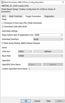

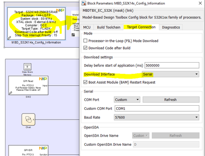

For the board not booting into the sent application, Can you please check in your model that the Download interface is selected for "Serial". By selecting this option, the generated mot file uses another linker file and this is the one that has to be sent over the RAppId Bootloader app. Can just for testing purposes try as well downloading over serial (not over CAN, directly from our toolbox) to see if the generated mots file boots up once the Download Interface is serial?

I can successfully (Program runs on board) download over serial using these settings:
So maybe something wrong with the linker? I also could have programmed the .rbf incorrectly as well as a guess

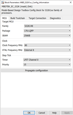

Also, how do I know if I have 192 or 256KB SRAM?

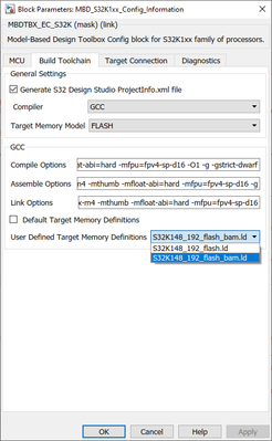

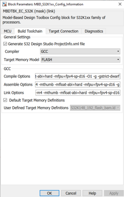

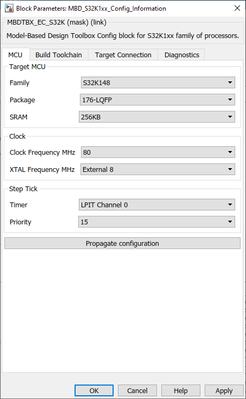

I have noticed that the 192 version only shows up in linker options even with 256 selected as SRAM. How do I know whether I need the 192 or 256 linker file? And if it's 256, how do I get it to select that one as only 192 shows in linker list. Here is my config box:

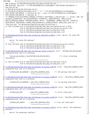

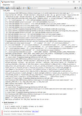

Also, I seems to get an issue where I can only build once in Simulink, if I try and build again I get the following error in the diagnostic box, is this something you have seen before?
Thank you very much for the help!

Just to add onto this I am now getting these errors when trying to build:
Do you have any idea why this would have just randomly started happening? Or the permission denied error before. It's not something silly like my Simulink version is it? Currently using 2020b.

For the errors, have you tried deleting the generated code folders, or maybe the CPU selection has been switched. Please try this and see if it is doing the same. Otherwise, please reset the MATLAB Path (Set Path to default) and inside our toolbox folder, there is a script called mbd_s32k_path.m. After the path has been reset please run the mentioned script file.

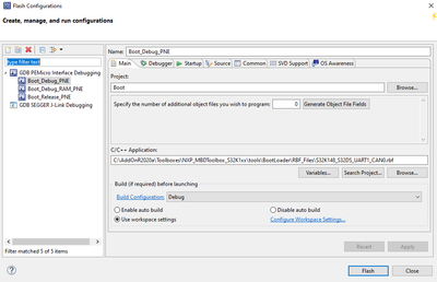

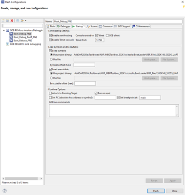

To see if I am doing everything right I use this process to flash the bootloader code:
And the I click flash, this seems to be successful.

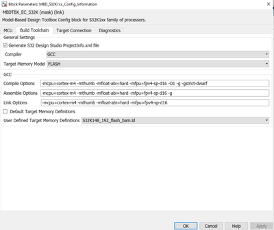

I then build my model using the following linker settings:

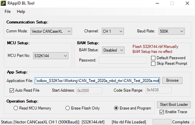

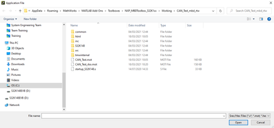

Lastly I take the generated .mot file from the Simulink build and add it to RAppID as shown:
This completes successfully but as I say it does not run any application code no matter how many times I reset. Is it possible to ask your colleague if I am doing anything obvious wrong? Or if nothing is wrong with my process do they have a simple Simulink model that they can test first, and I can see if I get the same result? (To see if it's something wrong with how I have set up my model)
