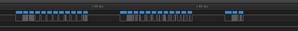

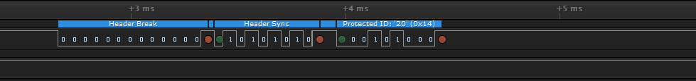

I've tried both your models, and I was able to see the same messages in both cases.
Once the board starts running the algorithm, I captured 3 frames:
The first one is the one with the identifier 21
Next is 19.
And the last one is the request from 20, right?

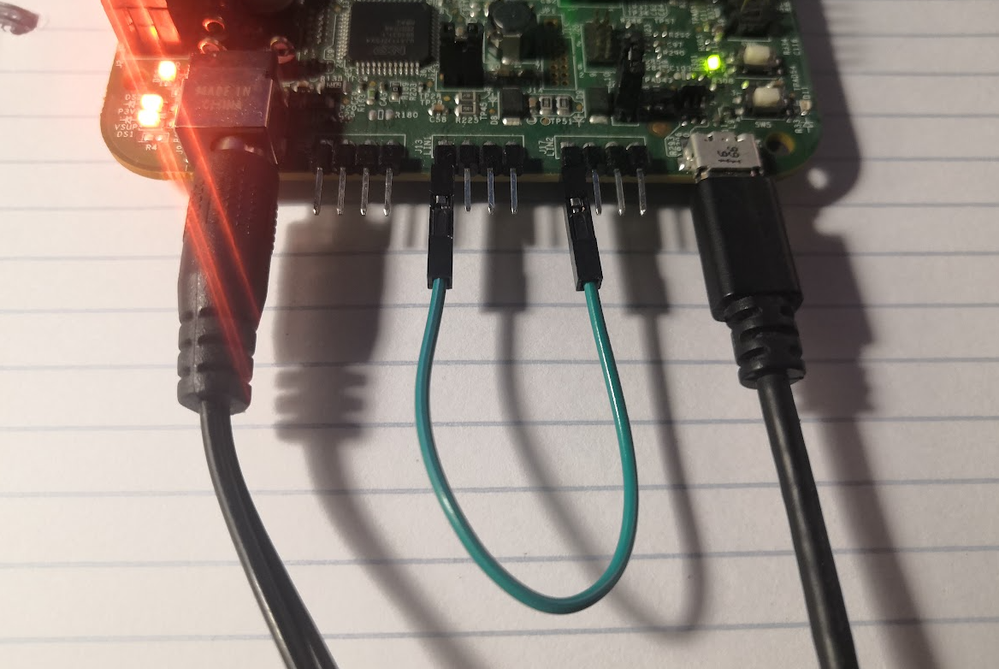

Also, I've added a simple model, to test the communication between LIN0 and LIN2, the ones on the S32K148 Evaluation Board. To test this model, you have to connect both LIN signals on the evaluation board just like in the picture below. LIN0 sends some data to LIN2 and you shall see a variable incrementing in the FreeMaster project.

Hi @mariuslucianand,
i've tried to run your model with the recommendet connection. But it doesn't work. It seems so, that LIN2 doesn't send any frame.
I've tried with a second same EVB. But nothing changed.
