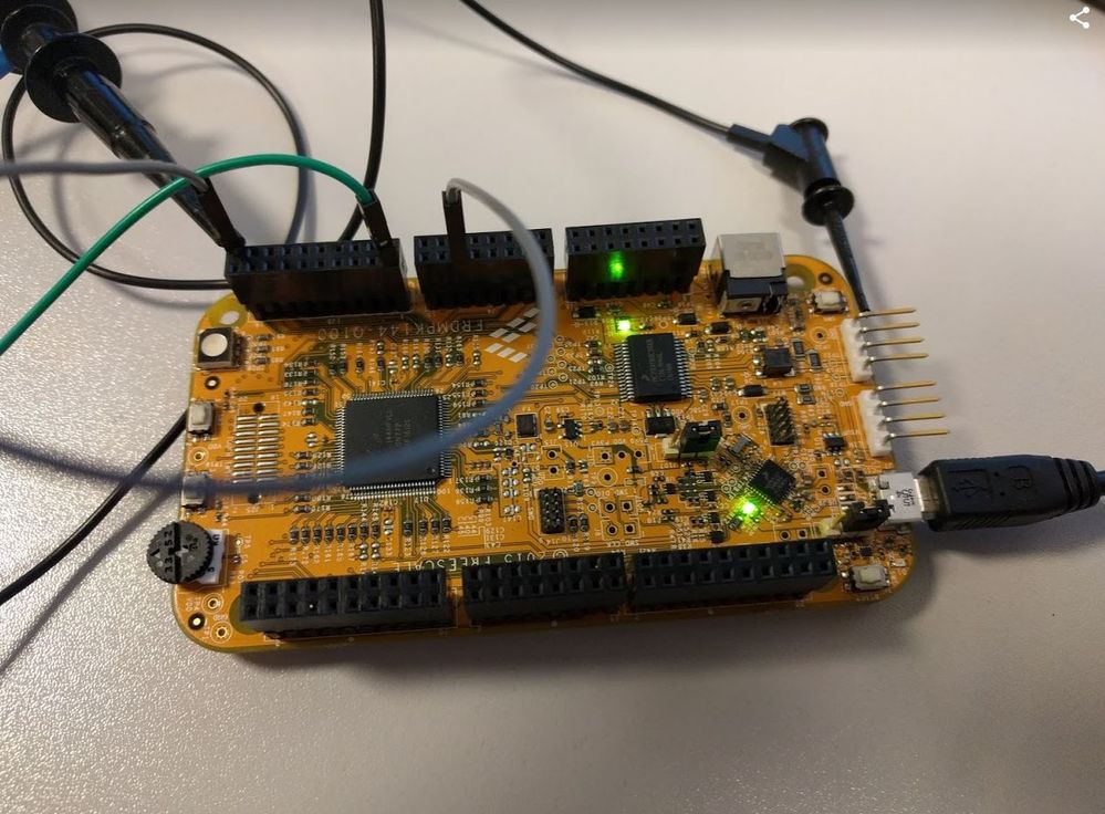

Hello Community,
i have a problem with the example "FTM Edge Capture" from the Model Based Design Toolbox v2.0 for s32k144.
I connected PTC0 to PTC 15 and measured a PWM.
But the Interrupt service routine is not executed. The LED shines red all the time without blinking.
Thanks for support.

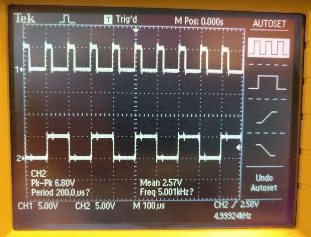

You should expect this:
Hope this helps!
