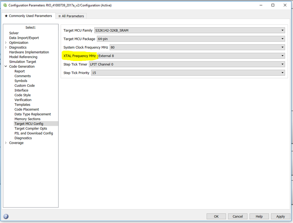

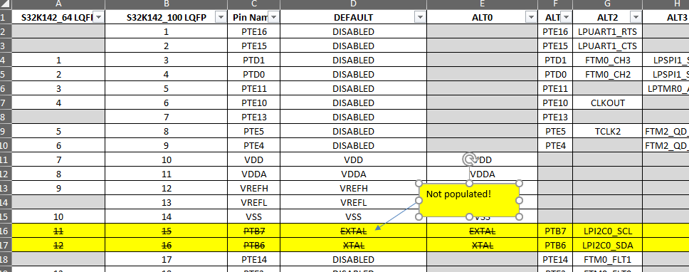

Hello!   I'm attempting to execute some basic code using the S32k (s32k142 variant) internal timer, instead of the external.   The prototype custom board I'm working with is not populated with an 8MHz or 40MHz external timer crystal, and the software configuration is not an option to 'deselect' either option (8 or 40).
Is there a way to execute the application software without using the XTAL pins?
Thanks for the help,
Andy

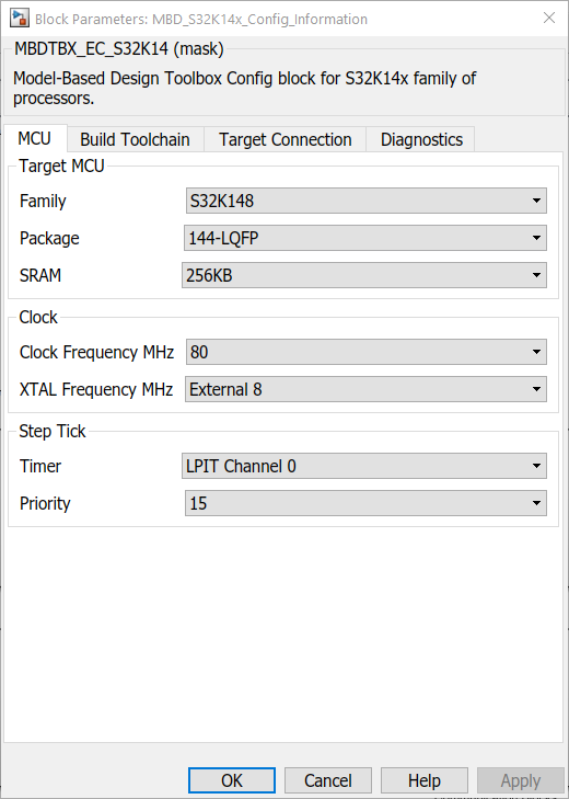

Secondly, regarding the clock options - in the new toolbox you will find them in the main configuration block - MBDTBX_EC_S32K14, under the MCU tab. As you can see in the image below, you have 2 options available: Clock Frequency and XTAL Frequency.
I will briefly present the 2 options:
  • XTAL Frequency - the one that you were having issues with - I must mention that we only use the Internal oscillator for OSC. There might be some ambiguity with the word "External" before the frequency. Let me try and make it a bit more clear:
pastedImage_3.pngStarting from the beginning - the internal oscillator (XTAL) has 2 options available: 8MHz and 40MHz. We have EREFS set to 1 (hard-coded), so the System OSC is always XTAL - basically 8MHz or 40MHz set in XTAL Frequency option. As we go further, this SOSC is used as input in the System PLL - so this makes it an External Reference Clock for the PLL. This is why we use the word "external" in the option itself - we'll discuss if we'll keep it this way or not for our future releases.
  • As for the Clock Frequency option - we're using System PLL to drive the Core clock - so when you set this to 80MHz or 112MHz we set appropriate values to some dividers and multipliers to get the desired value out.
As for the peripherals, we're dynamically checking the system/core clocks and setting the appropriate values for each peripheral - so this should not be an issue when selecting another option than the default one for either clock settings.

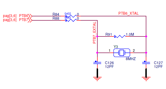

Is it correct to say that even when using the 'internal' oscillator for SOSC, an external crystal oscillator is still required, as shown in the Eval Board schematic below?
From this app note:
“The SOSC can source from either a signal driven into the EXTAL pin or a crystal oscillator connected to the XTAL and EXTAL pins (henceforth referred as simply “XTAL”). EXTAL can support up to 50 MHz, while there are two ranges that are allowed for the XTAL depending on configuration: 4-8 MHz or 8-40 MHz”
Andy K.

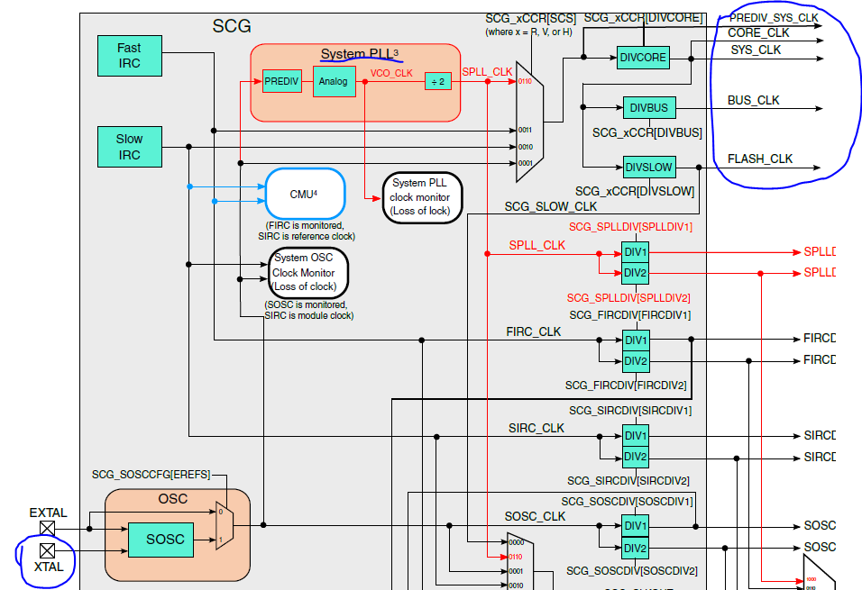

I am not an expert in clocks, but after a little more reading I can say that yes, you still need that - but we can just switch from using SPLL for SYSCLK, BUS CLOCK , CORE CLOCK etc. to using FIRC which is the fast internal reference clock. It is my understanding that for FIRC no external oscillator is needed. We can edit the clock configuration file if you need this switch.

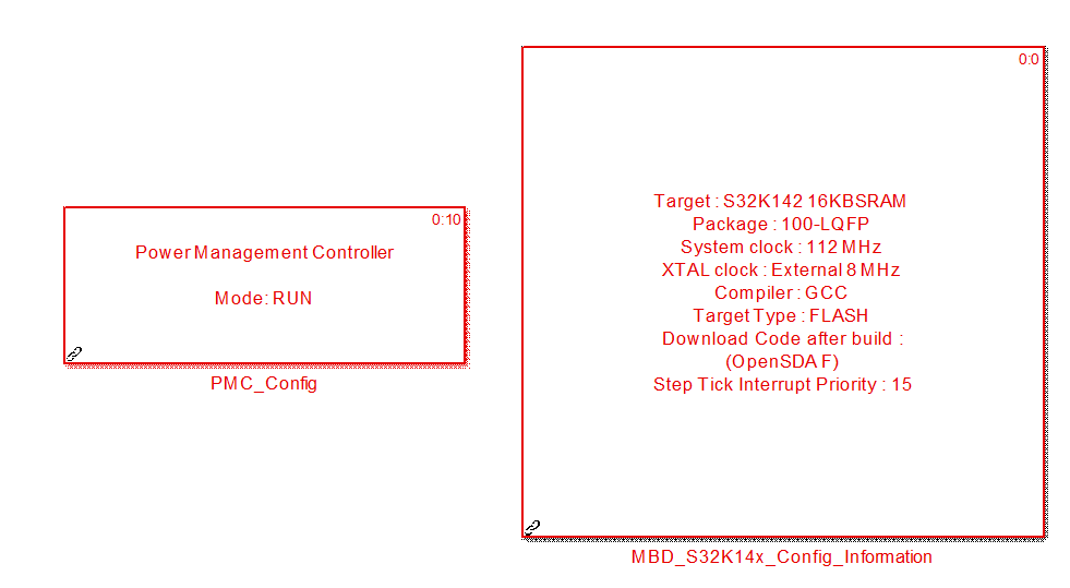

Thanks Razvan.  I have tried modifying s32k_clock_init.c as shown in the attached example.  I have changed all references to _SYS_PLL to _FIRC instead, but it appears that the SPLL/external crystal are still needed (if I short out the external crystal the application runs incorrectly).  If I set .spllConfig .initialize to false in s32k_clock_init.c, the application also fails to run.  Can you provide an example of s32k_clock_init.c that configures the system to not use the external crystal at all?  Alternatively, can you provide instructions on how to generate this file using the ProcessorExpert?  I have found the GUI for the clock options but am unsure of how to use this to generate the file apart from a full project (I only need this one file to use with Simulink).
Also, the default s32k_clock_init.c configuration appears to use FIRC if CORE_CLK_FREQ = 80 MHz and RUN mode (as opposed to HSRUN) is used.  I tried to force this configuration in Simulink as shown below.  Again, while this runs, it is dependent on the external crystal (shorting it causes the application to run incorrectly).
Any assistance you can provide in getting a configuration that does not use the external crystal at all would be appreciated.

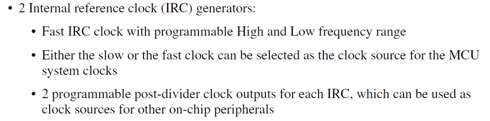

constantinrazva
Hello andyknitt‌,
I must be missing some configuration parameter, as this is for sure possible - it's stated as such in the reference manual (page 537 in the revision I have, under Chapter 26, System Clock Generator -> Introduction -> Features):
I'll start doing some tests today to find out what I've been missing and get back to you.
Kind regards,
Razvan.
15,581 Views
constantinrazva
Hello andyknitt‌,
I found what I was missing - the reason why the application stops once you short the XTAL is due to the way our applications work:
We use a timer (LPIT) to call the main loop (step function) and that timer is using the PLL as a clock source.
Please replace mbdtargetmainlibs32k14.tlc file found in
C:\git_ccr\mbdt_ccr_demo\S32K\src\mbdtbx_s32k14x\mbdtbx_s32k14x
with the one that i attached here. This worked on my side.
Note: we'll have to make some adjustments so that when you set the fixed discrete step to 1s, the timer will call the main loop at exactly 1s. I did not mind this changes at this point, as the purpose was to see if it works without an external crystal.
Note2: There are some other peripherals that use PLL as their clock source, so if you are using those, the application will not work. If you want I can make changes and select FIRC for all of them and attach them here.
Kind regards,
Razvan.
