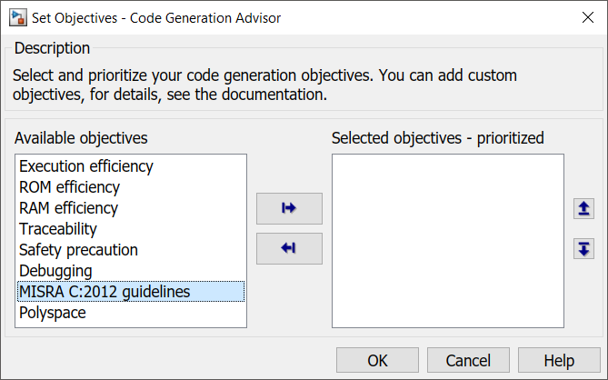

1) The generated code is complaint to MIRSA standard?
We need to differentiate between 3 layers of generated code:
  • front-end layer is the "User Application" that is developed using standard MathWorks Simulink blocks. For such use-cases the generated code is MISRA-C and ISO26262 and IEC61508 compliant (assured by MathWorks various toolboxes)
MISRA C setup:
ISO/IEC Certification Kit: IEC Certification Kit - MATLAB & Simulink
  • back-end layer is the "Peripheral Driver" code that is typically reused from NXP SDK. Those drivers are only MISRA-C compliant. In same cases, for toolboxes releases prior to mid 2017 including MCP574xP 2.0.0 those drivers are hand-written and not compliant - that is why we are currently working on switching MPC families to SDK PA drivers as well.
  • glue up layer between Simulink Application interface and Peripheral Drivers code is implemented in TLC by our team, and once again is not MISRA compliant.
