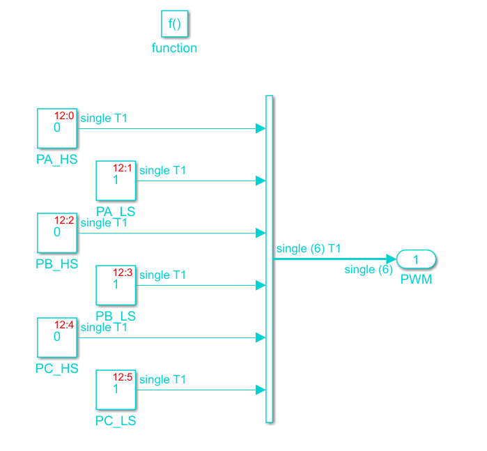

I am trying to initialize the Three phase field effect transistor (33937A) using MBD for MPC5744

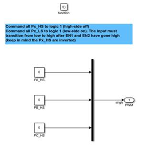

I am using the Example provided as : PMSM_ClosedLoop_mpc5744P (Snapshot 2)
For the steps 6a – 6f (snapshot 3)
Going in t2_init block (Snapshot 1) -> It says that Highside Off and Lowside ON -> but when I see in scope, both the sides are OFF.
Why is this happening?
Could you please explain how to achieve 6a – 6f (with PWMA inveted), because when I keep PWM value as 0, both sides are low and when I keep PWM value as 1, both sides are high.

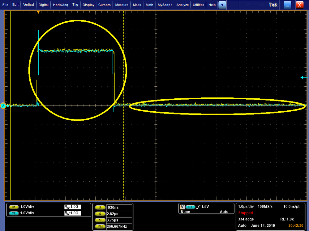

ext-rafael_barb
Dear dumitru-daniel.popa‌
So for the high side transistors to command those to go into conduction you need to send a logic 0 signal which then will be automatically inverted by the pre-driver.
The polarity in configured as inverted for High Side
Hence it is important if you have the change to test it with an oscilloscope on the actual MCU pins
I checked it on the MCU pins using oscilloscope -> High and Low
If I feed 0 value in PWM complementary -> Both High Side and Low sides are 0 V
If I feed 1 value in PWM complementary -> Both High Side and Low sides are 3.3 V
So my question now is
How do I get step 6b (section 7.3.3 in https://www.nxp.com/docs/en/data-sheet/MC33937.pdf) in IC initialization, where
High Side is Off
Low side is ON
Rafael

Daniel_Popa
I think the simplest approach is to use independent PWM to get full control over the PWM signal generation.
4,103 Views

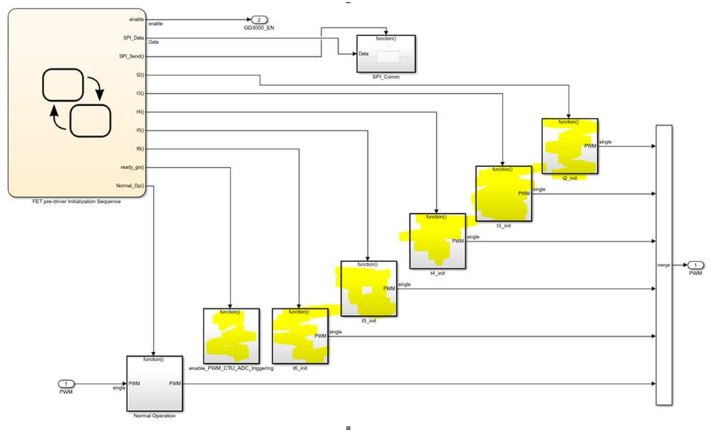

ext-rafael_barb
This is where the issue is coming as in independent mode, there is no possibility of dead time configuration.
So for the state of Initialization I use Independent mode.
For Normal Operation I use complementary mode.
Attached is an example.
If I try to initialize PWM in two different places using states (One for Initialization and other for normal operation).
I get Error
FlexPWM error: block 'PWMTest/PWM1/PWMA'. There should be only one FlexPWM Config block for each FlexPWM Submodule
Component:NXP MBD Toolbox | Category:Block error
FlexPWM error: block 'PWMTest/PWM1/PWMC'. There should be only one FlexPWM Config block for each FlexPWM Submodule

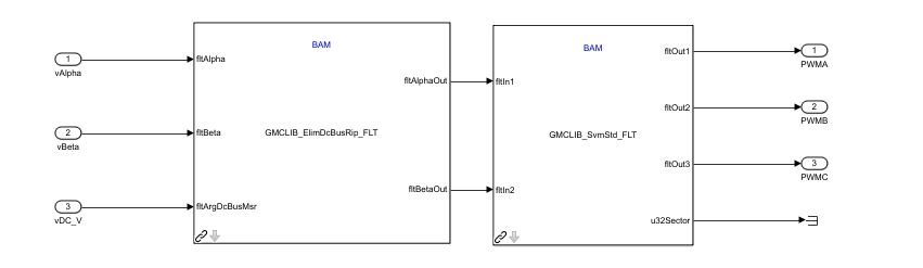

ext-rafael_barb
Hello dumitru-daniel.popa‌
I found a solution for this by inverting the PWMB too. This works specifically for me.
For me PWMA was inverted and I wanted to use GMCLIB_SVMStd_FLT block but for independent PWM (as you suggested).
So I inverted PWMB too and I can directly use the output of  GMCLIB_SVMStd_FLT. (model attached)
Thank you for the hint.
