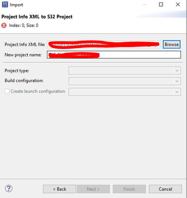

Hi all,
i am trying to import the ProjectInfo.xml (generated from Matlab) in S32 DS.
Unfortunately this failed with the following issue.
Anybody an idea what is wrong?
Softwareversions:
  • Matlab 2018a
  • Model-Based Design Toolbox for S32K1xx Series Version 4.2.0
  • S32DS 3.4
Thanks in Advance.

Hello DenisK,
In order to use S32K1xx toolbox, you need to download and install S32 Design Studio for ARM.
Bancila Sorin

Hi @SorinIBancila,
with S32 DC for ARM it is working.
Thank you for your help.
