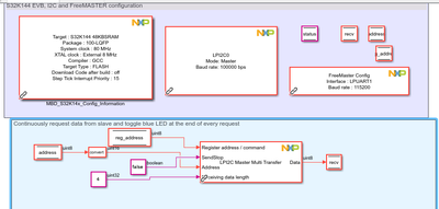

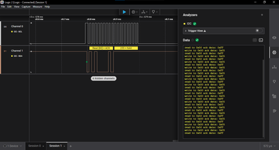

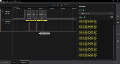

I am using s32k144 to read and write data from an external EEPROM. I will attach the model below. I am able to write the data but the read returns 255+NACK as output. Am i missing something here
Is there a way to specify the register address of the EEPROM in the I2Cmaster block
Can you guys help me out with this issue.
