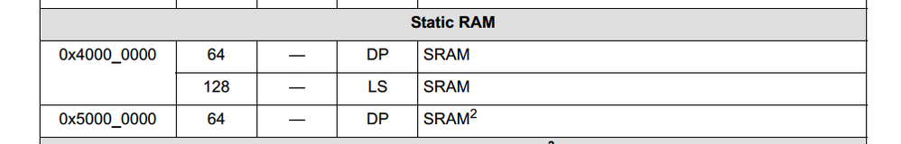

there is another question about the write address of the memory:
1#Can i configure the in the Calibration address in the ROM that is 0x0000 0000-0x2000 0000,that is right?
2#or i must configure the Calibration address in the the RAM?
3,849件の閲覧回数
Daniel_Popa
Should be RAM address since after boot-up all data are copied into RAM.
