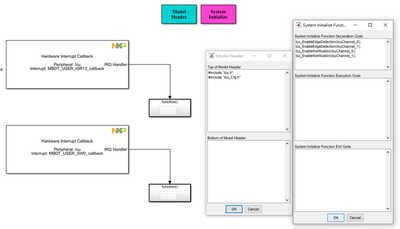

It works fine when I use model headers and system initialization for DIO configuration interrupts.
But unfortunately, it is not convenient for people to use BLOCK to view.
I can successfully build the program to the S32K312EVB-Q172, but my interrupt function is not working.

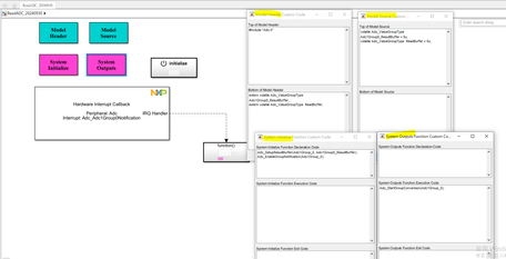

I upload my ADC config file "1_SimulinkCoder_ADC", can you help me to solve this problem?

BTW, My goal is to change the ADC value by changing the variable resistor (PTA11) on the S32K312EVB-Q172.

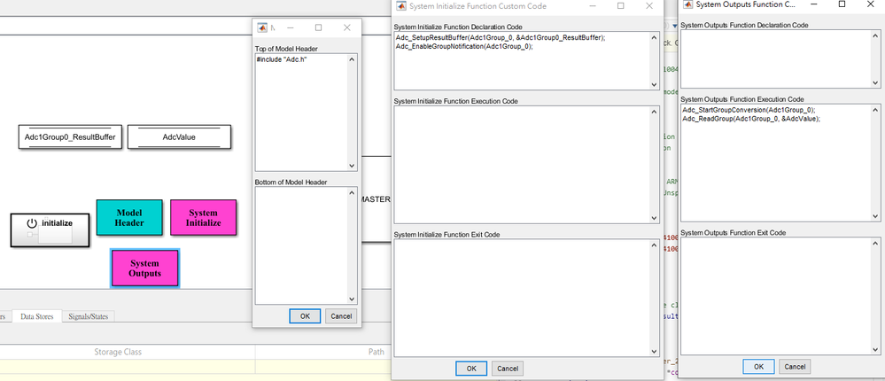

I looked at the example project - "s32k3xx_adc_single_read_s32ct" c code to figure out why I couldn't use the custom code correctly.
Thank you for your suggestion.
I'm attaching my configuration here, hoping it can help anyone in need.
