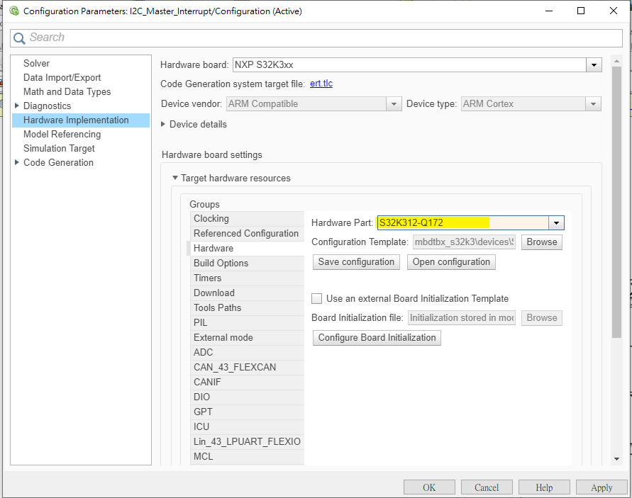

1.  Choose Hardware: S32K312EVB-Q172

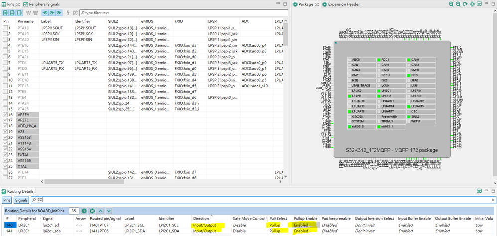

2. SET I2C PINS: LPI2C1 SCL, SDA

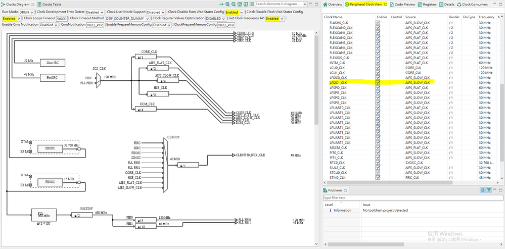

3. Make sure LPI2C1 Clock Reference: AIPS_SLOW_CLK

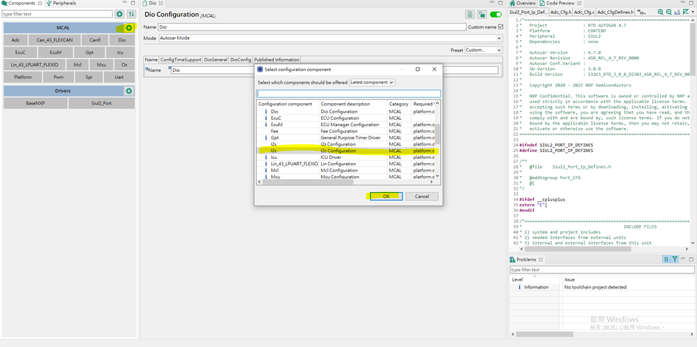

4. Add I2C tab

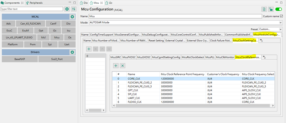

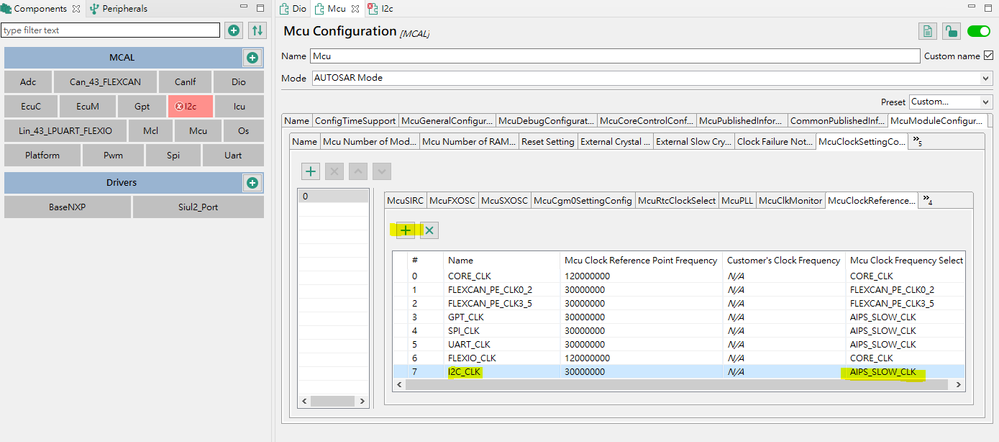

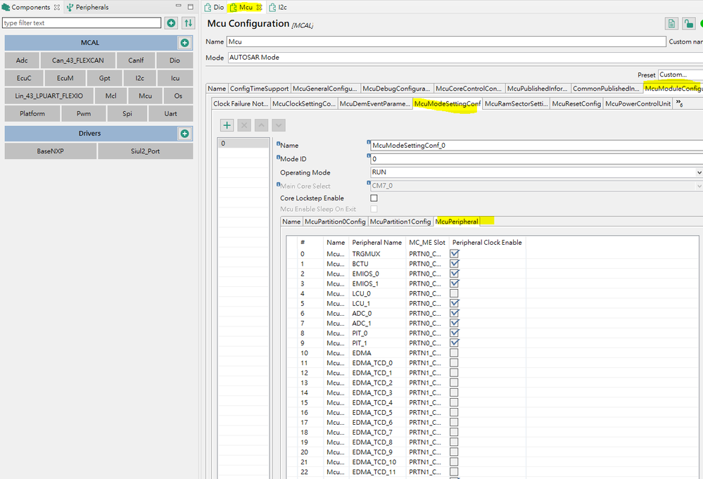

5. Mcu tab: LPI2C 1 Clock Setting & Enablement

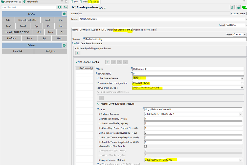

6. LPI2C1 Setting: Standard Mode, 100kb/s, Slave address: 10bits, using Interrupt

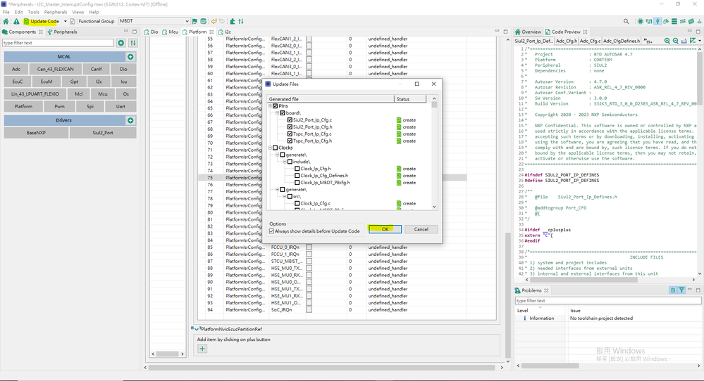

8. Code Generation

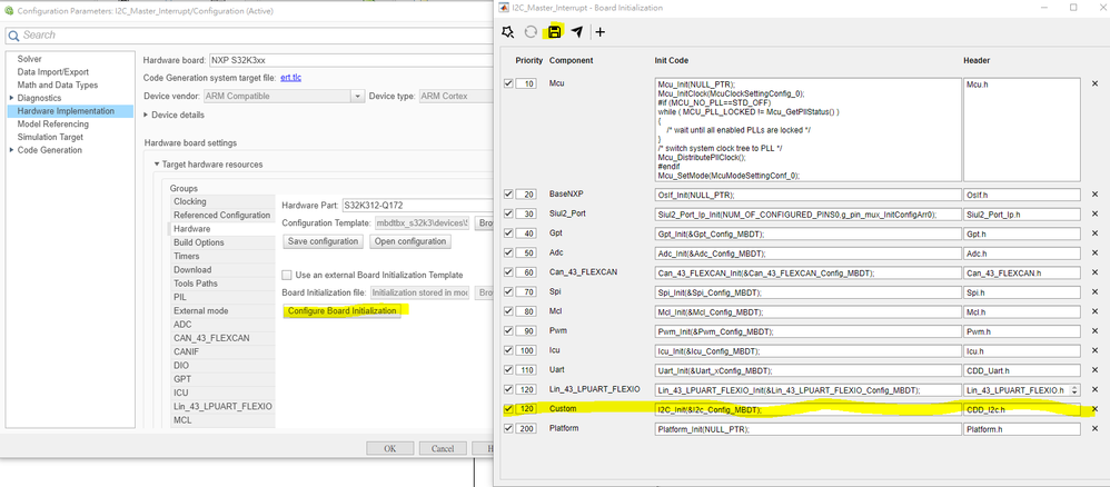

9. Add I2C component in the Board initialization

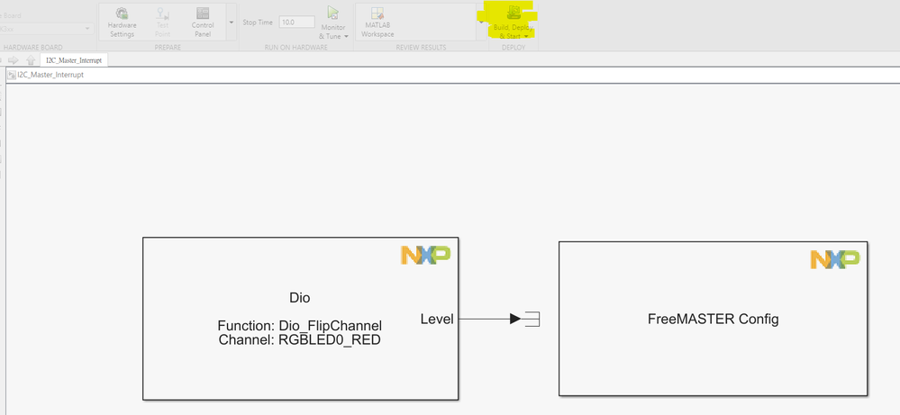

10. Simulink Model - Build, Deploy & Start
When I try to building the program, it gets an error message.

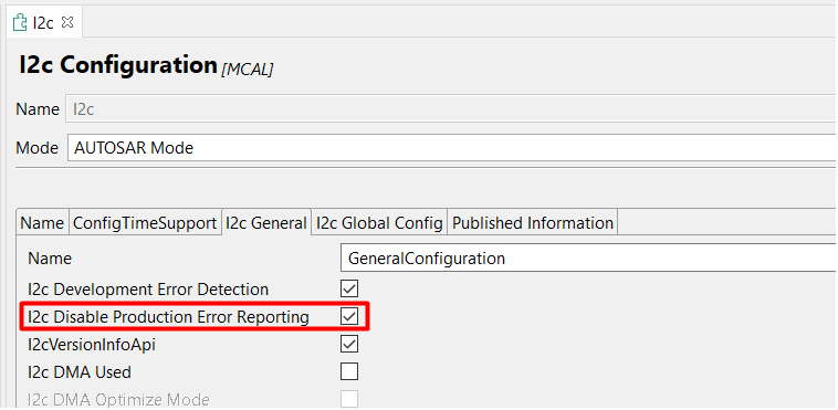

The encountered error occurred because the Dem component is not configured in the S32CT project, and the Dem source and header files are not copied to the Config folder next to the model at build time. This error can also be bypassed by checking the I2c Disable Production Error Reporting option in the I2c component. When this option is checked, the Dem.h file is no longer included in the CDD_I2c.h file.

However, another error message is currently generated, namely "xx_Config/RTD/src/I2c_Ipw.c:221: undefined reference to 'MBDT_I2c_Callback'".
I check "xx_Config\src\mbdt_board_init.c" and find that the program lacks the declaration of the I2C Callback function, that is, "__attribute__((weak))void MBDT_I2c_Callback(uint8 Event, uint8 Channel) {}"
I guess that's why the error occurs.
