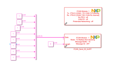

I have encountered a problem where the CAN configuration is as follows. After downloading the code, there are no messages on the CAN bus. What is the reason for this.

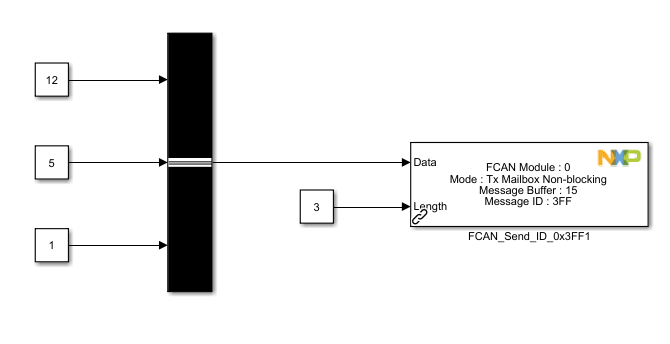

I'm not sure I understand what the problem is. If you are trying to send data over CAN using our toolbox, you can just send the data directly, and the rest will be handled inside the generated code - there is no need to make the entire CAN frame.
For example, using those 3 Constant blocks from your example, just put them inside a Bus Creator (with 3 inputs) and send the output of this block to the FCAN_Send block. All you have to do is add the length (another Constant block with value 3). Now this data will be put inside a CAN frame and sent over the network.
Let me know if you have further questions.

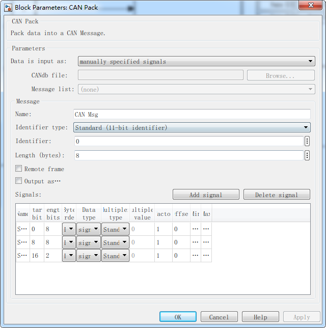

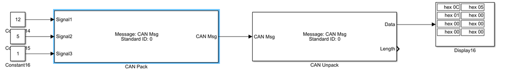

花了4个小时终于搞定了。
Canpack(Cehicle network toolbox)+Busselector+FCAN_SEND(MBDtoolbox)
1 Set the Canpack ---  output as bus。
2.Set the busselector -- 7outputs。SET the lastoutput as the CAN_SEND's in1[data].
finished!
